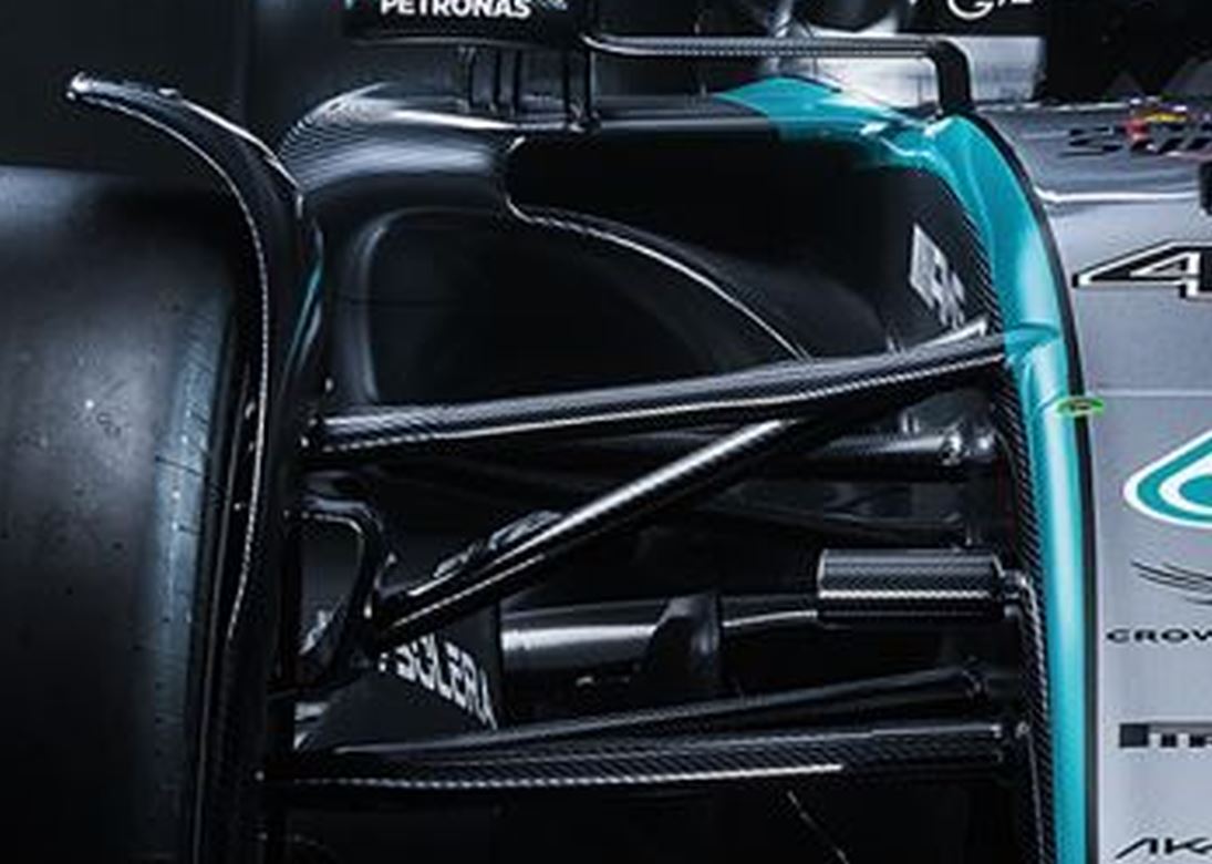

Re: Mercedes W15
Vanja #66 wrote:
06 Apr 2024, 08:12
Hi Vanja, I`d like to pose you some questions had you are willing to explain your thoughts about them:
1. The sidepod shape besides having an undercut also seems to have a spiral/funnel shape, or is it just me? What`s more advantageous in this area: to have a clean flow, a powerful vortex, or both?
2. The so-called lip of the sidepod air intake has a forward ramp. What`s the aim of this shape/structure?
3. On another side note: the above photo/render (a desktop wallpaper from the official team`s website) doesn't sport any diverting air slot at the sidepod air intake...

Re: Mercedes W15
atanatizante wrote:
11 Apr 2024, 14:22
https://postimages.org/
1) Yes, something like a funnel to increase pressurisation effect for more outwash with less local frontal surface area. There's no specific vorticity in that area worth mentioning now to the best of my knowledge.
2) In my view this is a way to make a hybrid solution that uses some functions of Ferrari s-duct but for cooling flow, mostly to clean up the boundary layer
