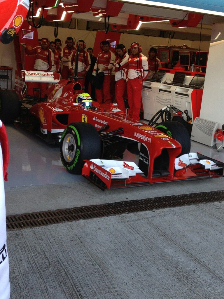

The vanity panel would have to endure pressure from air flowing at it of over 300km per hour. Still think the engineer is pretty confident, given that it would have to be designed for this, that its strong enough to be pushed on the nose tip..poz wrote:I suppose that this image close any speculation on Ferrari nose tip. If it were made by the "vanity panel" i suppose they will not use it to push the car...
