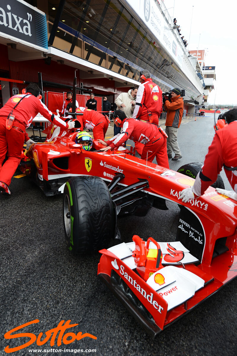

Matt Somerfield ‏@SomersF1
Ferrari F138 - New Nosecone, note the strake that runs along the outside of the nose via @SuttonImages
https://pbs.twimg.com/media/BEMHKCKCUAAcyzn.jpg:large
The nose strakes remind me of the "chines" on the fuselage of the SR-71 Blackbird, so I believe they have been applied to gain a similar (if inverted) effect :
Wikipedia wrote:The SR-71 featured chines, a pair of sharp edges leading aft from either side of the nose along the fuselage.
*snip*
Aerodynamicists discovered that the chines generated powerful vortices and created additional lift, leading to unexpected aerodynamic performance improvements.[37] The angle of incidence of the delta wings could then be reduced for greater stability and less drag at high speeds; more weight, such as fuel, could be carried to increase range.
http://en.wikipedia.org/wiki/Lockheed_S ... ird#Chines

scuderiaF2012 wrote:.the only thing i can see is the strakes on the nosecone..
Strakes were debuted at the last test, but these ones are fitted lower down the side.
