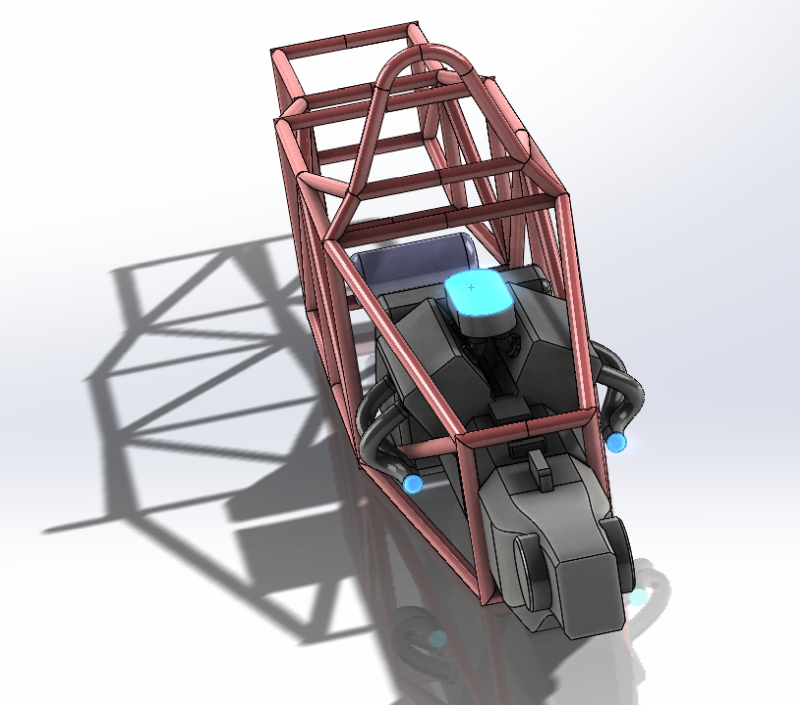

Last update for today: engine inlet/outlet monitoring/BC surfaces will be already set and included into the template (they are highlighted in the image below, but I have not modeled the space behind them yet). You will be free to design the final part of the exhaust and the airscope (different and creative solution will be accepted).

CAEdevice wrote:
14 Dec 2019, 13:04
https://www.caedevice.net/SERVER/Formul ... _00004.jpg
Looks like fun! I assume you are using weldments to model your vehicle?

maunde wrote:
15 Dec 2019, 10:36
CAEdevice wrote:
14 Dec 2019, 13:04
Yes, I am using weldments and structural members, but the frame will be released as a STEP (the same for any common part).
