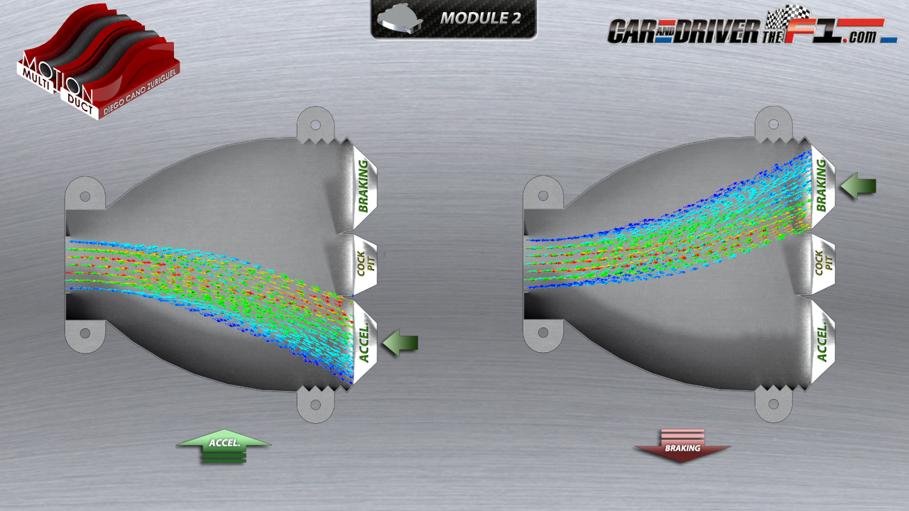

5. MODULE 2
- The uniform and centering airflow that reaches to the "Module 2" is deflected proportionally to the longitudinal displacement the car. In accelerations airflow is deflected backwards, and in braking, because of fast deceleration and the design of this module, is deflected forward.
- To the end of "Module 2" there are 3 outlets:
                 - 1 Outlet for acceleration in straights
                 - 1 Outlet for braking in straights.
                 - 1 Intermediate output to cockpit.
- The airflow enters the corresponding output in proportional manner and without mingling thanks the intermediate output that sent extra airflow to the cockpit.
- The airflow that entering in the outputs for acceleration and braking in straights, in this case is sent to the front wing.

what i don't get is: why does the air change direction in the modul 1, though it has a uniform exit in velocit through the filter1 ?

pascaljackson wrote:what i don't get is: why does the air change direction in the modul 1, though it has a uniform exit in velocit through the filter1 ?
This is because when the airflow would be deviant to left or to right in the first corner, the airflow would be remain adhered to lateral walls of Module 1 (due to boundary layer effect), and it not would take off up in a long time, although car turn a intense corner in the opposite direction. Diverting again the airflow, is always free into the Module 1. I've simulated many times this other optión ever with negative results.

bucker wrote:I'm comparing this with Lotus system last year at young driver test, when they have some braking thing. it wasnt operated by driver but it was illegal.
If i remember correctly, Lotus system was meant to modify passively but DIRECTLY the hight of the car, which you can't do. This new system acts indirectly.
piast9 wrote:I also don't get the idea of Module 1. How the car lateral movement would affect the airflow inside it?
If i am right, it should work more or less like this:
_The air cleaned from any turbulence goes into module 1 (and 2... the principle is the same).
_The duct bringing the air in the module ends with a shape similar to this: ) air (.
_The air flowing between the "parenthesis" is quite unstable, which means that it is in a situation where it stalls with the "parentesis", but when subject to transverse forces it attaches to one of the parenthesis (mostly thanks to Coanda Effect).
So, let's suppose that we are going straight with no acceleration (=no forces); in this case the air simply keeps going straight in the module 1, stalling with the parenthesis, like this: ) air (
Now, let's suppose we are turning: the air is subject to a transverse acceleration (that in Formula1 goes up to 5g, or 50m/s^2); therefore the air is pushed to one of the parenthesis, where it atthaches and creates the Coanda phenomenon, and remains stalled with the other. Like this: ) air( or this: )air (
Basically, the stronger the force, the stronger the Coanda, the larger the deviation.

bucker wrote:You need angle of steering wheel, gas and brake pedal. All those things are operated by driver in my view its illegal
This system working thanks the difference of lateral and longitudinal velocity of car. The wheel, brake or throttle, does not enable or disable directly this system.
Imagine a firefighter that moving one hose left and right, the water jet seems to deviate in the opposite direction, but it deviates the firefighter. In this case, the firefighter would be the car, and the waterjet the airflow into the first step of the Module 1. This system is fully fixed, without any moving parts, all does the air. For example, the Double DRS uses the DRS to be activated, the MM-Duct is always activated.
