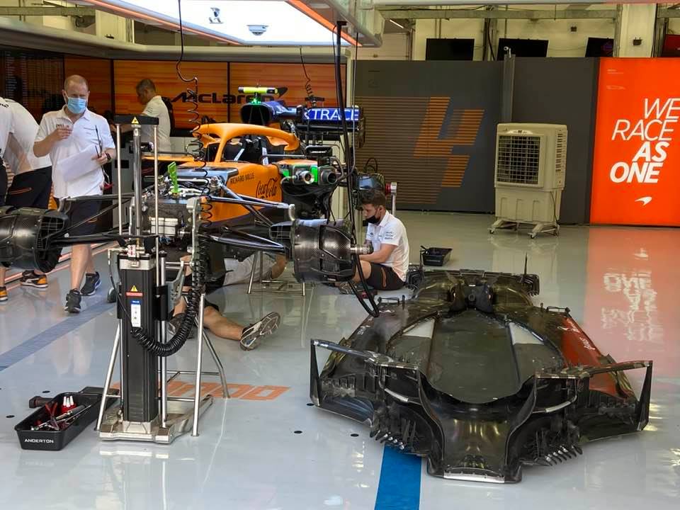

That's a nice picture, but it doesn't mean anything on its own.
How does the alula of a falcon relate to that part of the floor? What's your thesis?
Re: Formula 1 Aerodynamics - article series and general discussion
hUirEYExbN wrote:
01 Apr 2021, 17:33
The part on the car and the falcon alula are both creating a tip vortex that helps keep airflow attached to the wing/top side of the floor.
Both the bird and car have a similar profile from the alula to the tip of the wing, and the device on the car to the tapered section of the floor. My thesis is that the bird design can help guide the development of the car.
Of course the bird is trying to generate lift(the inverse of an F1 car), and the bird doesn't come with spinning tires, but the design principles are the same. The bird is trying to guide airflow in a similar manner to an F1 car only inverted.
If you notice, the alula curves inward, while the device on the F1 car curves outward, IE inverted.

The stooping falcon is a lifting body and the alula is a roll control device. There is no correlation between what a stooping falcon is doing and what an F1 car is doing with the air flow along the edge of the floor.
The alula curves the way it does because it's normally held against the surface of the wing and the feathers are shaped accordingly.
The F1 floor edge VGs are designed to roll up a vortex that spins in a specific direction in order to interact with other similar vortices generated up stream.
Where the alula does mimic human designs (or rather vice versa) is in high angles of attack. Then the alula performs a similar role to the leading edge slats on a human-built aircraft wing.

Wouldn't this be beneficial if you're interested in increasing the pressure of the upper side of the floor near the rear tire?
Place one on the floor edge before it tapers allowing you to run higher angle of attack on the geometry of the floor near the rear tires.
Place them ahead of the bargeboards so that airflow from the Y250 stays attached to bargeboards and deflectors despite the high angle of attack.
Yes, I'm aware they already do this.
Where I'm interested is in the way the wing tapers down, like the floors do. Although if we have to invert the bird for it to work in F1...
There's absolutely no similarity in design?
If you turn the floor upside down, it'll generate lift like the bird, if you turn the bird upside down, it'll create downforce like the floor.

OK, I understand the connection you are making.
My understanding is that falcons use their alulae to fine control force and moment balance (and consequently flight direction) when in their freefalling teardrop stage. The car uses their floor doohickies to keep flow attached over the upper surface of the floor?
If I'm right in my assumptions there, then I'm not sure I see any connection other than purely cosmetic.

Then why put them on the bargeboards and edge of the floor? You can see on the picture above on the floor of the McLaren that the little flicks right before the floor tapers resembles the bird.

Resembling in appearance does not mean they are similar in action.

In nature, form tends to be strongly correlated with function. From chemistry to physics. Unless the birds are using a different type of air than F1 cars, then they're subject to the same physical laws.
What's good for the goose, is good for the...F1 gander.
