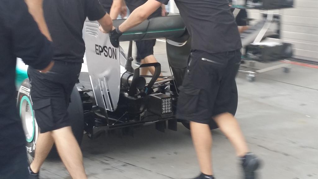

Interesting monkey seat
Via @AlbertFabrega

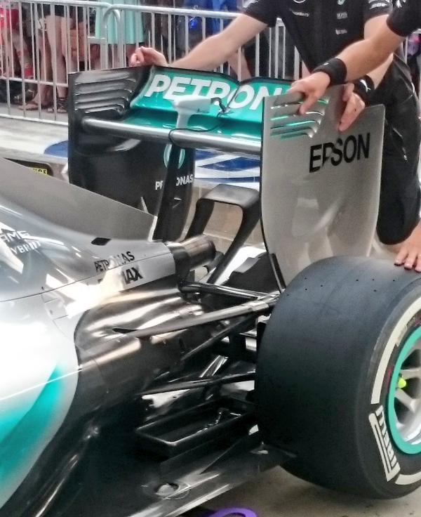

closer look, wonder why they don´t run with "the monster"
593
Re: Mercedes AMG F1 W06
Maybe they don't need the bigger version - perhaps they've found the equivalent downforce elsewhere. The Monkey seat is an inefficient beast so perhaps they've found a better way.
1081
It's very curious given that the W05 ran with the "Gorilla Seat" pretty much everywhere.

Even though everyone runs max downforce here frontal grip is vital at the Hungaroring. You need a strong front end for turn 4, 8, 9, 13 and 14. IMO you need good rear stability only for turn 11.
That's what Mercedes went for they are using the smaller monkey seat just for that rear stability but the focus is on having less understeer as possible.

NewtonMeter
NewtonMeter
Joined: 24 Jun 2010, 21:48
Location: Pretoria, South Africa
One should remember that the monkey seat isn't used directly for downforce. Rather it's used to keep the flow to the rear wing attached. So they must have found another means to achieve it. At least for the aerodynamic requirements of this circuit.
(That's my understanding of it, anyway)
