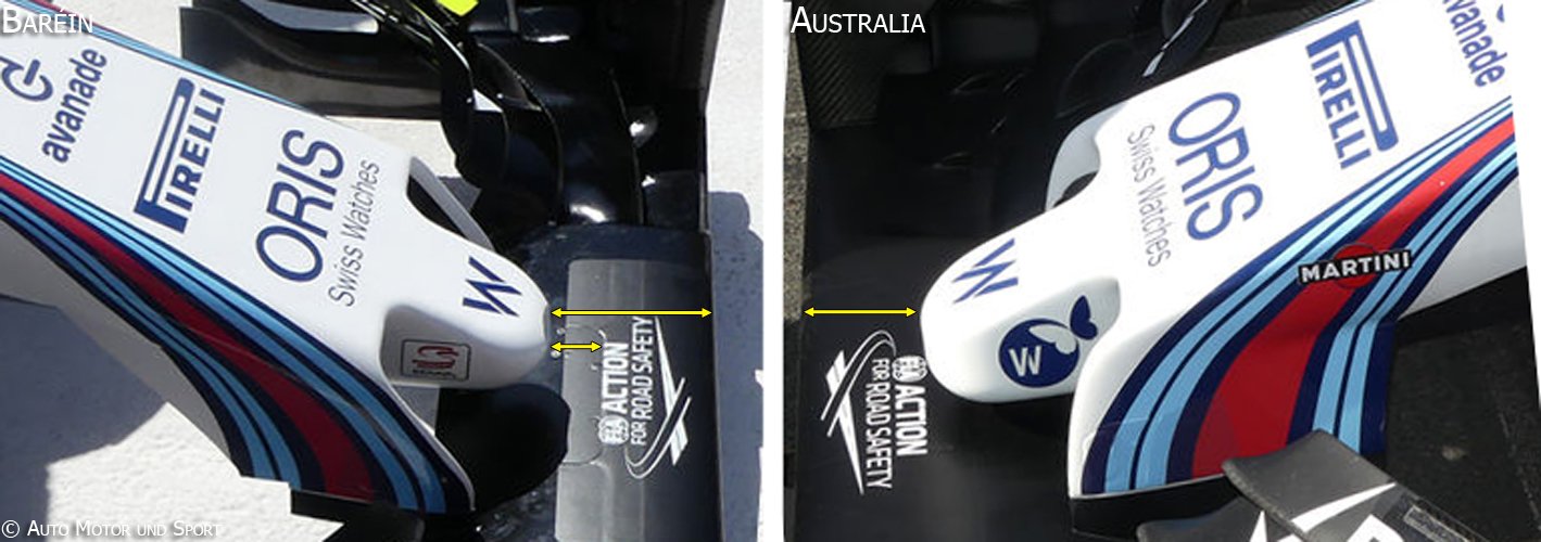

tomazy wrote:Williams didn't say such a thing, This was only speculation when they saied that they have a new shorter nose comming.
You're right it was Autosport not Williams that was saying the new nose would be like the Mercs.

This area had changed quite a lot:
Pic ot he area from yesterady:

from G. Piola:
"Under the nose, in the part that remained color carbon there is an opening that leaves presuppose the adoption of an S-duct system similar to that mounted on Mercedes W07 Hybrid. This news must be associated to the front wing designed specifically for this solution."
1081
Re: Williams FW38 Mercedes
Not to engage in armchair aero(but doing it nonetheless), the underside of the nose is a lot more sculpted and that is a good thing.

Sevach wrote:Not to engage in armchair aero(but doing it nonetheless), the underside of the nose is a lot more sculpted and that is a good thing.
If we didn't engage in armchair aero, this site would be extremely sparse.
And yes I also think the more rounded/sculpted nose would provide more consistent airflow over a range of yaw and pitch. I have an armchair too.

Also looks like the front wing dips down a bit after Y250 similar to the Mercedes. Whereas the old wing was flat.
