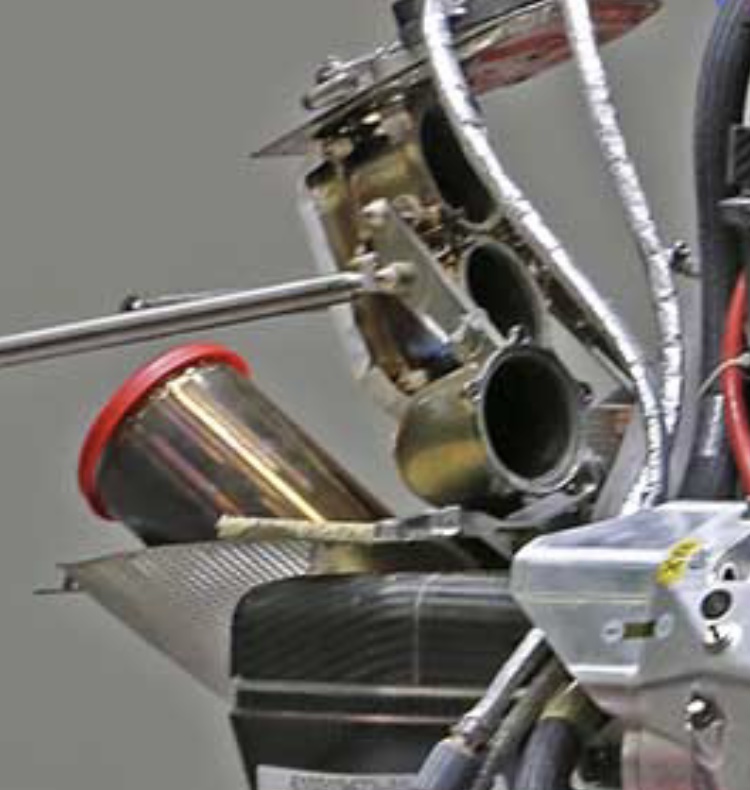

In the early days the Ferrari wastegate was almost as large as the main exhaust. Which might suggest effectively a total loss of turbine power when in use.
Working from this image (probably a 2014-2016 engine) I measure the WG feeders as dia 130 px each (27k px sq total area) and the main exhaust as 190 px (20k px sq total). The feeders and valve area are probably oversized to minimize losses but not by much. I would assume the WG area (post valve) for this era engine was roughly equal to the main exhaust area. Given the shared exhaust exit, what if any energy could be harvested by the turbine if an equal area path is available without obstruction?
