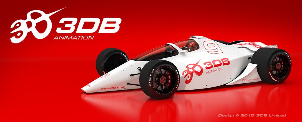

Chris Beatty Veloctiy RPB-01 car proposal.
Joined: 24 Feb 2013, 14:07
Apart from not having a front wing, i think this is very interesting as there is little doubt F1 will head towards aeroscreens/canopies either way sooner or later as an upgrade from the HALO.
I like Jeroen Claus' design here on the board too, which are essentially F1's current cars with a wider cockpit and a aeroscreen mounted and implemented instead of 'slapped on'.
apart from that, this is a very interesting desing route too, and has been worked out in detail. The engine proposal won't happen, but we don't need to as the 2021 + V6TT KERS system will deliver 1000+ HP probably 1200+ HP either way.
exiting is not a big deal
driver POV
POV lap on SPA
https://vimeo.com/159074121
more:
https://www.chrisbeatty.co.uk/
554
Re: Chris Beatty Veloctiy RPB-01 car proposal.
Nice design and great rendering. The car itself looks boring though.
The car looks like a muscular Formula Ford with enhancements from a good plastic surgeon.

So do the 2009 cars now!!
It's a start at least...
It's a good solid base to do something with. It's designed originally as an indy proposal, hence the different 'angle' - more minimalistic. Frankly, 'just' add modern wings front and back and improve on the sidepod design and you're on a very interesting route i'd say.
Interesting idea,
I'd like to see how this car (and the halo for that matter) is easy to ger out of when its up side down in a gravel trap. Remembering that some of those gravel traps can be pretty deep.
NathanOlder wrote: โ†‘
10 Aug 2017, 14:25
Interesting idea,
all that needs to happen is to add a rollbar on top of what is now the upper part and i'm sure the possible 'gravel trap' issue is accounted for.
that design might be better for formula e. unless there as some massive hidden vents and air intakes a race car engine needs more air than that little gap at the top
marmer wrote: โ†‘
11 Aug 2017, 07:57
perhaps you should look a little better.
Manoah2u wrote: โ†‘
11 Aug 2017, 09:18
marmer wrote: โ†‘
11 Aug 2017, 07:57
the front side pods are fine i was more meaning the air box and the lack of vents to the rear
He should add a basic frontwing left and right with basic endplates, a high and big air intake/rollhoop, and a basic rear wing with big endplates and it would be the F1 car of the future. Without wings this looks abit too much Formula Ford of the future.
The whole thing is just pretty pictures. It's entirely a graphic design exercise with little, if any, technical thought. The "tunnels" aren't tunnels and would generate little downforce. The balance would be entirely rear biased too, although the so-called rear wing is just a glorified engine cover so probably would be pointless.
Piff and dribble. That's all it is. Shame so many in here buy into the pretty art work.
Just_a_fan wrote: โ†‘
12 Aug 2017, 01:41
You're right. Among other things you can't legislate for aesthetics, that's why this year we have shark fins (personally I don't mind) and T-wings. He suggests it as a car to enable nose-to-tail racing, but has massive wheels on the car which are the biggest source of downforce loss for the following vehicle. The chassis might work for a spec formula where low drag is necessary because power is an issue, so I could see something similar to this for the next Formula E car, but with the all weather tyres and wheel covers.
If he suggested it as an oval configuration a rearward aero-balance is desirable for stability, reducing front load from ~45% to ~30-35% from road to speedway would be typical.
He may only be a graphic designer and he is (at least in part) responsible for the updated aesthetics of the Indycar for 2018 (sans screen/shield) which looks okay if compromised aerodynamically. They're using the same tub as the DW12, which I always felt looks a bit tubby, and have reduced the total downforce substantially (-35% IIRC) from an already fairly low benchmark in top-flight open-wheeled terms, 2018 Indycar will have less downforce than F2 and Super Formula.
12 Aug 2017, 01:41
you're completely missing the point. it's a design excersize but it's main point is the closed cockpit desing which is quite frankly really done well, with all the tools to extract a driver, keep him safe, how to get out, etc.
all other stuff is non-important and just there for visuals. the technical thought was put into the capsule, that's where the attention lies. that's where it is for, not for a non-winged racecar. the idea is about the capsule, to protect the driver according to stricter safety demands by the FIA.
Except it doesn't protect the driver because there is no space between driver's head and the structure. Any impact will result in large acceleration being transmitted to the driver's head and thus brain. In a Bianchi style crash, this structure will mean the impact is just as fatal as his was.
Providing space for the driver's head is one of the issues that has been raised time and time again on this forum when these schemes are discussed. Yet again it has been ignored in favour of things that look cool.
