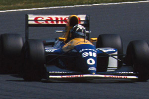

There is noway that visiblty can be increased in the current F1 cars and the reason for this is not the height at which drivers sit but because of the high cockpit side impact protection.
This was a major differance between 1995 and 1996, drives helmets visors were always ligned up against top of cockpits but the low sides ment drivers could pop their head out and see where the wheels were during a turn in. The low nose does not make a differance.
This is a modern day low nose (not 1994 low but still)and the driver sees nothing of the front wing or nose cone.
