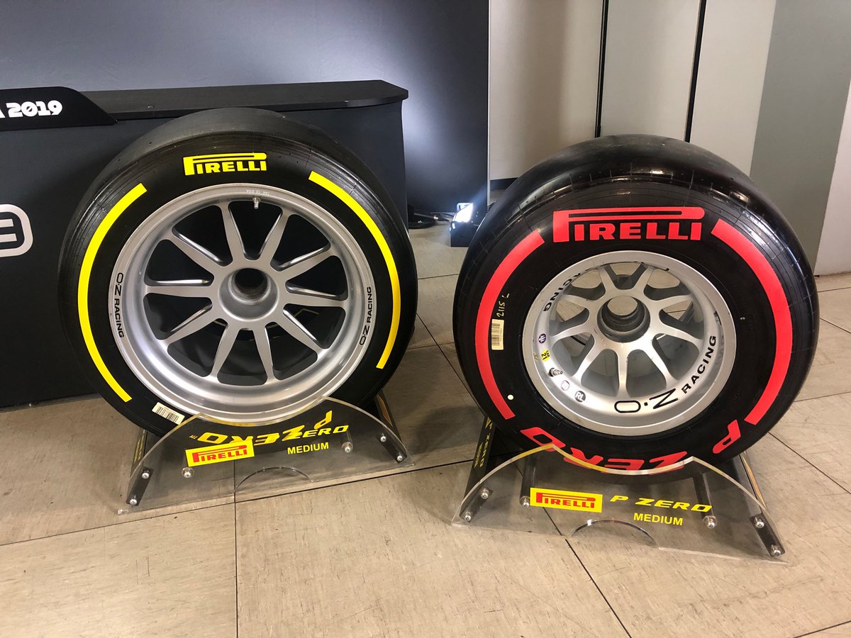

So they are going to give F2 a head start with 18 inch rims in 2020 before introducing them for F1 in 2021.
2020 18-inch vs 2019 13-inch wheels

Morteza wrote:
09 May 2019, 14:16
https://pbs.twimg.com/media/D6H9aHRX4AI-WIy.jpg
https://pbs.twimg.com/media/D6IFY_1WkAI8aOY.jpg
Makes sense for Pirelli to get an extra years development - even if it's not F1 speeds.
