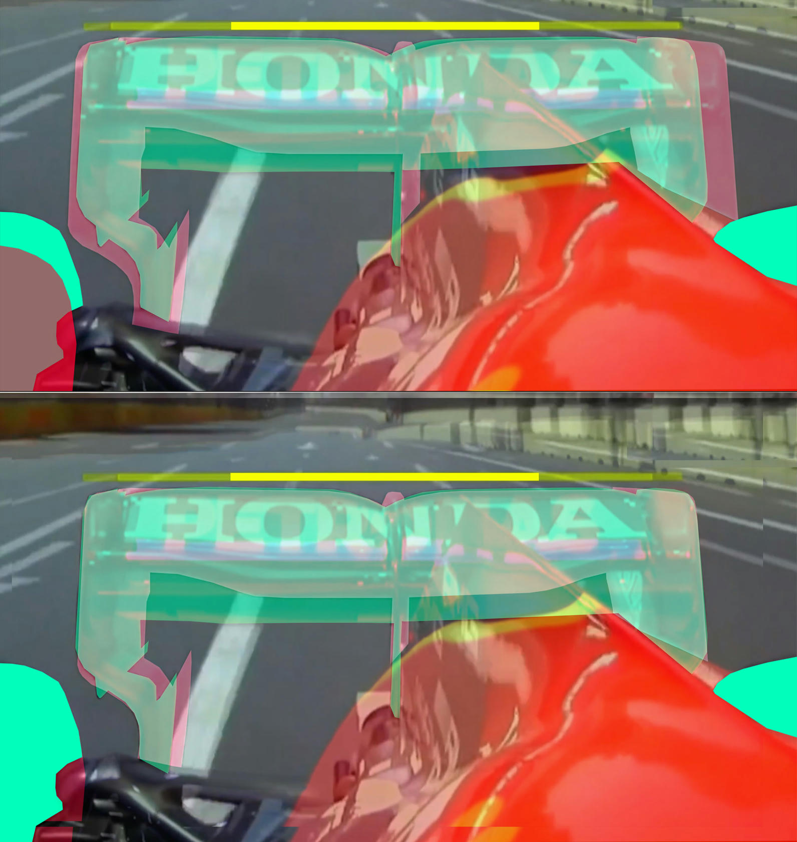

I appreciate the effort at normalizing the footage since it's pretty apparent that the RedBull's camera distance is closer to the rear wing than the Mercedes. This in effect will make the appearance of the dip ever so much more despite the yellow line (which also would need to be re-scaled) drawn on the footage as being placed when the wing is deflected. The FIA would have to have some clever calculations and measurements of the camera lens position relative to the markers on the wings. A side by side comparison really has no real significance at this point since it really doesn't matter whose wing is flexing more based on non-normalized video feeds based on camera position variance.
With the footage overlaid on top of each other the camera difference and wing perspective/parallax is pretty obvious. The cameras placement itself would need to be standardized relative to fixed measuring positions in order for it to be a reliable regulation enforcing tool. With the footage overlaid it's pretty obvious this isn't the case. Teal is MB, Ping is RedBull.

It's not necessarily just the distance (the difference wouldn't be that big(?)) maybe different lenses or zoom, it's the same on the front facing cams - i'm surprised that sky didn't bother with adjusting the videos so that both wings would at least have roughly the same size, that's some very basic video editing.
I believe that it's "close enough" to scale the images based on the wings' width (i'm adjusting with the aspect ratio maintained), at least when the visible difference in tilt is large enough, here i specifically just wrote it's similar.
I also believe that the FIA is clever enough to do some (probably not overly complicated) calculations since they will know all distances etc ... and they're not comparing different wings to each other but the same wing in different situations so the differences from the cameras shouldn't play much of a role, if any at all.
But yea the last image was just about downforce levels, that's why i put them side by side.
