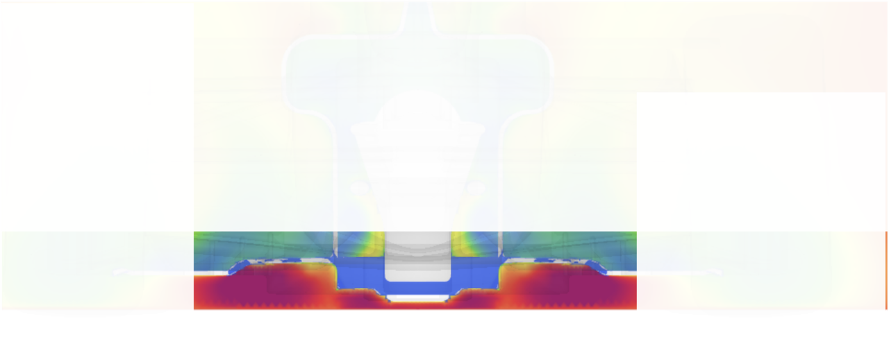

Any idea why this would be happening? (I am still using last years Mflow)
This only happened after I lowered the ride height to 20mm. All the stl files are the same as the sim without lowering ride height.

The Rusted One wrote:
24 Mar 2025, 08:50
You have a hole in the mesh. Either figure out where the bad geometry is (small gaps, acute angles etc) or try increasing the stl resolution on that part.
