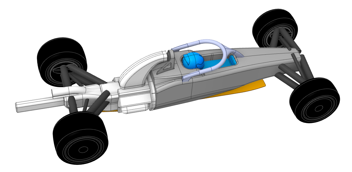

Well, this was just an observation from my side. If those are the official rules, let's tackle them! :)
From my perspective, the mandatory monocoque body is too high, especially in the HANS section.
A cut like this (in orange) should work fine, in my opinion.
Removing the part marked in yellow will provide more design freedom. :D
Nevertheless more opinions would be helpful.

Well, this was only an observation from my side. If those are the official rules, let's tackle them! :)
Your observation is correct, a larger gap (5mm is enough) would make modeling a bit easier and surfaces obtained by blending or sweep smooter. F1 teams have people dedicated to modeling with advanced surfaces, we don't.

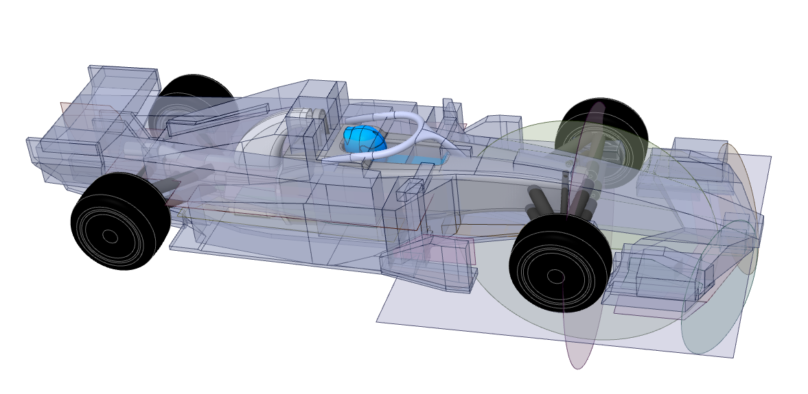

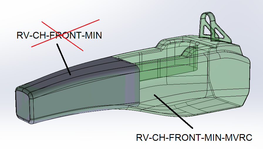

Just a quick uodate befeore releasing MVRC_Volumes_R02.
The original FIA RV-CH-FRONT-MIN ruled volume, will be fully replaced by MVRC "RV-CH-FRONT-MIN-MVRC". You might find the original volume in the common files only as a reference.
CAEdevice
50
Joined: 09 Jan 2014, 15:33
Location: Erba, Italy
Re: [MVRC] Mantium Virtual Racecar Challenge 2025 (Grand Prix Cars)
This is the latest release: https://www.dropbox.com/t/2r6FWLEqfJWAn19Z
The link will be available only 5 days as usual.
I tried to include all the requests/suggestions, let me know anything you think might be improved.
Wheels are still non divided into rotating and not rotating volumes, I will do in R03.
Keep in mind that everything is a compromise between realism, the need for simulation, the need to simplify legality controls and design freedom.

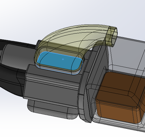

I have a few minor comments:
I think the RV-FLOOR-FENCE is missing (defined on page C215)
The enginecover surface protrudes a bit from the reference volume:
The suspension parts currently contain both the mandatory internal structure and the outer reference volume, these should be seperate parts. And imo the inner pushrod pickup point on the front suspension is too high up
Otherwise I think it is a good adaptation of the reference geometries. I think that we should write the rules while simplifying the volumes. So, how do we do this in the best way? I have started working on a draft of the rules. We can use this a basis for the discussion, where I update the content based on comments from this thread. This draft also contains more MVRC specific changes to the geometry.

Koldskaal wrote: The enginecover surface protrudes a bit from the reference volume:
It looks there is a mistake in the original rule, but anyway, I simplified a bit that area for MVRC and solved the issue
