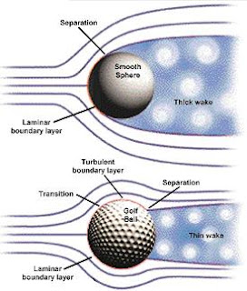

Finally, I conccur with qw56q. We posted
some time ago and
not so long ago this image, a little more specific (it
could help to clarify qw56q post, if needed):
The squares to the right of the images represents drag: the white one represents the drag because of low pressure at the back of the shape, the black one represents the skin drag of the shape
As you can see, when you have an aerodynamic shape, like a wing, the pressure drag is very small. So, if you put dimples on top, you don't "get back" enough "wake energy" from the increase in drag caused by a rougher skin. This only works for blunt objects (or for wings in stall, which have a low back pressure).
