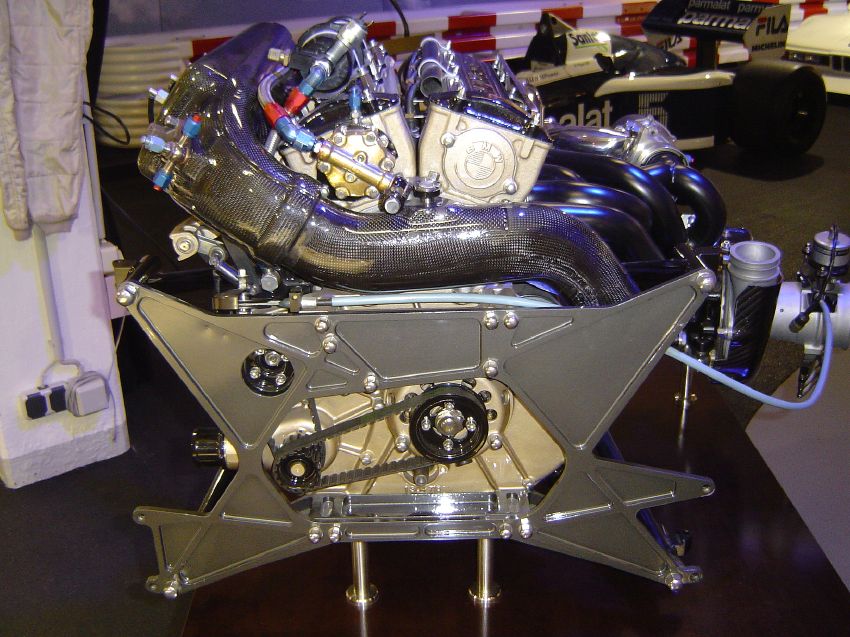

Just to throw a spanner in the works, Marmorini also said that it wouldn't be possible to use the I4 as a load bearing member in the same way as the current V8s without having a "huge engine casing".
The quote (translated from Italian) was
Besides this, Marmorini notes that to install an inline 4 cylinder engine would require a complete redesign of the chassis. "Like this it won't have a structural role", explains the Ferrari engineer, "It needs a reinforcement structure around it, if you are to do without a huge engine casing."
Source here.
ringo
230
Joined: 29 Mar 2009, 10:57
Re: What will come after the 2.4 V8?
This is true becuase of how norrow the engine is, but even with a bigger casing, it will still be lighter than the V8.
It's trivial really because everyone will have the same thing regarding the chassis.
I think Ferrari can make the engines, but whether they will be the most balanced, efficiency, reliable is something they are afraid to get wrong.
They are competing with companies that can make L4 engines in their sleep.
Load bearing structure:
from gurneyflap.com
These could be metal or carbon pipe. Or the engine itself could be designed to take the loads.
