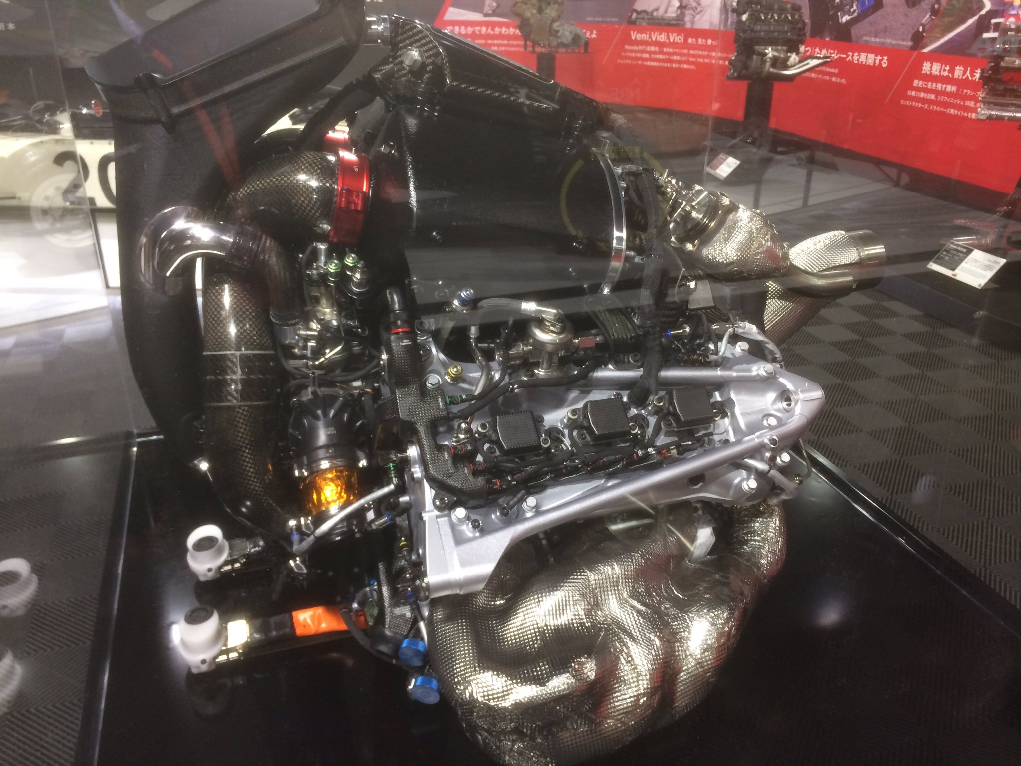

Some photos of 2017 PU
Oil tank and compressor inlet
Side view on compressor ala Merc position
piping from plenum to cylinders, 2 pipes per each bank, red arrow is regulator for wastegate

What's a good reason for running four pipes to six cylinders?

hurril wrote:
05 Oct 2017, 11:38
1 for low rpm and 1 for top end power? Or 1 per 3 intake valves, so you have mild vtec engine :)

Singabule wrote:
05 Oct 2017, 13:12
hurril wrote:
05 Oct 2017, 11:38
Ha! But yeah - I thought about running one per three valves.
