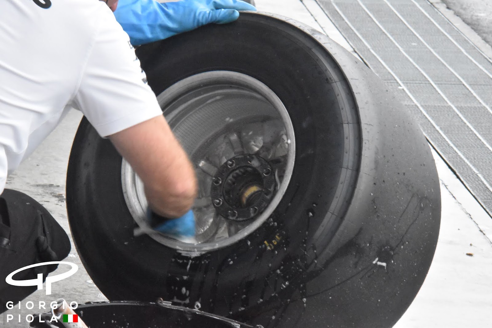

No, the fail is on your behalf as you clearly didn't read through or translate the F1i.com page correctly. The 3 images shown here: http://f1i.auto-moto.com/magazine/magaz ... gique-3/3/ are, in order from top to bottom, Mercedes new wheel with the outer fins, Mercedes old design for comparison and Red Bull's wheel from inside in order to show how teams use the heatsink style bumps on the inner face, as the author probably hadn't got a Mercedes one at the time.
No-one (but you) has claimed that the lower image in that article has ANYTHING to do with the Mercedes wheel rims, you're simply trying to connect two independant articles with one another by virtue of the fact that they have a similar mating face, but perhaps fail to realise they both take their supply from O.Z. and so will obviously share a level of commonality.
If you do need independant verification of the wheel design, here you go, one that Piola took of the Mercedes rear wheel from the inside...
And for anyone else that cares, or wants to see how the fins and new spoke configuration affect the wheel rim we have this one...
Re: Mercedes AMG F1 W09 EQ Power+
Matt, although I do agree putting it down as a "failure" was really uncalled for, people who will watch the video will get the impression the side by side pictures show the design with the holes on the left and without holes/filled up on the right, especially with it showing "USA" on the picture. It's nothing more than a detail, it doesn't change anything to the story, but it could give the wrong impression how Mercedes filled up the holes.
I do agree the article should been read when people reposted the picture here, which was before the video was brought out.

So the question is: in detail, what do the holes do? They don't connect in to the tyre volume, obviously, as that would cause the tyre to deflate. So where does the air in these holes go? Does it just get fired out through the V shaped voids at the inner end of the wheel spokes? Presumably that's why Ferrari aren't happy - they think it's for an aero effect. Actually, they probably don't think that at all and just want to make life difficult for Mercedes. Which is fair enough, all teams would do the same in a tight battle such as this season. The air going through the V at the inner end of the spokes would obviously reduce the heat going in to the outer part of the spokes and thus the tyre volume.
We know the design must be for cooling - if the intention was to heat the tyre volume, the ribs would be on the inside of the rim only, not formed as hollow ribs. The hollow rib obviously allows the cooler outside to increase heat draw from the warm inside thus cooling the tyre volume.
I suppose the worry, going forward, is that the same might be tried in the front wheels as a way of replicating the blown hub device which is, of course, purely aerodynamic in intention. Maybe that's the real driver for Ferrari - are they thinking "here's something for next year, let's push and see how happy the FIA really are. We might be able to use it ourselves next year if a solid precedent is set". Again, others will be watching carefully for the outcome and thinking the same thing.
