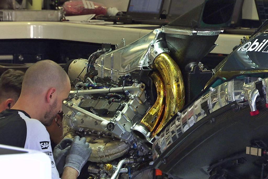

Are the golden pipes of the first picture the boost pipes to and from the intercooler? If so, then the compressor is indeed at the front and the turbine at the back of the engine. MGU-K seems to be positioned under/besides of the engine, as by the other teams. MGU-H in the V of the engine?
