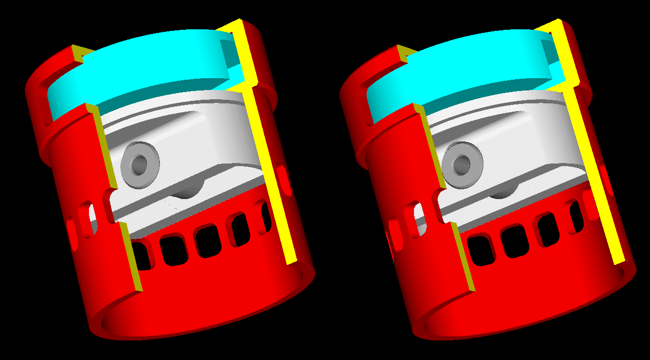

Here is a stereoscopic animation of the 2-stroke PatRoVa FlatHead:
Thanks
Manolis Pattakos

The Tribology on that is going to be a nightmare. Thermal expansion, and sealing, blow-by etc​.
Is going to need high pressure, requiring lots of energy, reducing efficiency.
How can it support direct injection and Jet ignition for the advantages of ultra lean combustion and multi phase combustion where you injection further fuel at max heat release to maintain cylinder pressure as done on the F1 engines with tji. Multi phase combustion when performed effectively increases the Bmep significantly. The ideal Crank angle of maximum heat release is typically 8-14 degrees depending on crank geometry and engine management strategy in regard to the wide fuel equivalence ratio typically 1.4-2.5 times as much air as stoichiometry with no loss of pressure at 1.85. The piston not descended much at that angle, expansion ratio is good to introduce more fuel and maintain cylinder pressure burning more oxygen available from ultra lean operation of tji and the increase of compression ratio tji provides typically 2 points or more.
The power per stroke increasing up to 80% depending on exhaust flow rate, where the Bishop valve excellent flow helps. Normally aspirated Bmep of over 20 bar is easy and highest useful compression ratio 17.3:1 provides high 40s thermodynamic efficiency when not hindered by F1 regulations.
Offset crankshaft provides friction reduction and piston motion advantages, increasing the tdc to bdc duration, and crank rod angle for more effective conversion of pressure to torque with less bearing friction and torsional issues.
Engine management strategies really start to get pretty wild with the versatility available with TJI and DI.

Marc, to be fair..
.. I don't think you need to get too critical about the simply illustrative concept that Manolis
drew up to show how a horizontal application of his rotary valve might function.

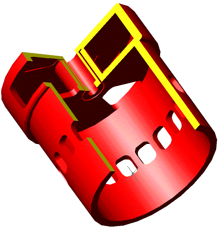

This drawing
shows / explains how things can operate without friction.
At top left it is shown a shallow trapezoidal “groove” arranged oppositely to the “left” exhaust port (which is cut on the ceiling of the combustion chamber).
This shallow groove communicates, though a “small volume” passageway with the combustion chamber (in the specific case this passageway is formed around the hole / thread wherein the spark plug is bolted).
As the pressure inside the combustion chamber increases, the gas, through the exhaust ports, presses upwards the PatRoVa rotary valve at its bottom side.
However, at the same time, at the top side of the PatRoVa rotary valve it is applied an equal and opposite force due to the high pressure gas in the shallow groove.
This design can eliminate the total “gas pressure force” on the rotary valve, eliminating the frictional force and keeping the “sealing clearances” tiny.
In comparison, a (2-stroke or 4-stroke, it doesn’t matter) Cross – Bishop – Watson rotary valve receives, during the high pressure period of the combustion, an extreme total force and requires big diameter strong bearings and big clearances.
If it is still not clear, I can further explain.

manolis wrote:
22 Apr 2017, 09:15
Hello all.
Muniix wrote:
“The Tribology on that is going to be a nightmare. Thermal expansion, and sealing, blow-by etc.
Is going to need high pressure, requiring lots of energy, reducing efficiency.”
There is a misunderstanding here.
The rotary valve shown is substantially different than an Aspin rotary valve:
< snip >
Using gas pressure via gas ports is never "at the same time" and why this method is never used as the primary means, it is used as a secondary means as it takes some time for the pressure to build up, like charging a capacitor, it also takes time to discharge. One has to control the energy both acoustic and heat to do what is needed. Carbon buildup is possible.
Case in point - piston rings, their tension performs the seal and gas pressure used to assist.
This gas porting increases crevice volume and loss of cylinder pressure, creates additional heat that needs to be managed.
