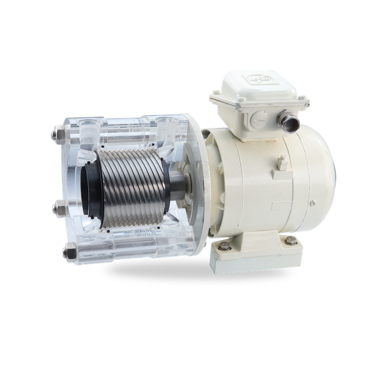

Axial was an odd choice simply because you can't have an axial outlet. The connecting shaft prevents this. Even at it's most basic implementation it was a compromised idea. The compressor outlet needed to do a 180* bend with a turboshaft running through it. Restrictive. Makes no sense. Then there was the space, size, and speed issue on top of that. Why did they do this. Big company, millions of dollars, amateur mistakes?
dren wrote:
07 Aug 2018, 21:07
Sounds like an elongated screw but axial flow.
I've seen pictures of wartime/pre-war turbines or compressors that looked like worm gears, but I can't find any. Here are a couple single-'stage,' single-screw hydraulic screw pumps:
Would a scroll compressor could meet the letter of the rules? While matching speed with the turbine.
Eccentric mud motors come to mind. A pneumatic version would probably be inefficient, hard to balance, prone to failure. Right at home on the RA15H, then.

The later looks like fun to balance at speed.

125,000rpm. Mmhmm.

Modern day compressors do look like that actually. Screw compressors. Just like your typical roots supercharger too.
This design though very efficient, has a LOT of drawbacks in terms of rotation speed. They are heavy and cannot rotate very fast. A very small clearance is between the casing and the rotors. For good "Bite" a minimum of two rotors are needed so the timing gears add more weight. The gears have to be oiled and god help you if the oil gets too hot. They are also large for the same amount of air flow as a radial compressor.
