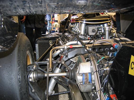

I'd like to add to this relevant post. Back in the 60's when Ford spent a lot of money chasing LeMans, they did a lot of pioneering groundwork in analysis and information gathering. They discovered that when under full load, the driveshafts of the GT-40 flexed up to 270 degrees. Remember, a driveshaft can be treated as a torsion bar.riff_raff wrote:scarbs,
The drawback with inboard brake rotors is the torsional wind-up that occurs in the drive shafts. It makes the brakes feel mushy and unresponsive. Getting positive feedback through the braking system is very important to drivers. The fastest drivers are always the ones that brake latest and accelerate earliest thru a corner.
