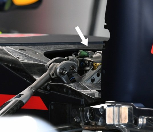

Comparison: Merc & TR.

Re: 2017 Formula 1 suspension designs
#1 would rule out inertia valves. How to enforce #4? Perhaps a limit to the fluid or gas volume per damper. Or dimensional regulation which would limit reservoir size & distance from the plunger.
