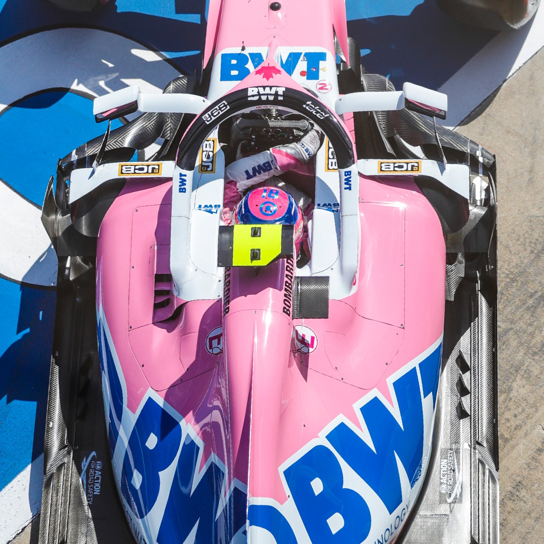

Asymmetric halo cooling outlets.

I think it's likely they are doing a direct comparison of the two rather than intending to use them in this configuration.

Heat exchangers aren't symmetrical on both sides. Typically engine water and oil one side and charge air and electonics cooler on the other, with gearbox oil fed through roll hoop, but many configurations are possible.

+ Water and oil do not have the same thermal capacity. But do you think that the difference may increase with altitude/atmospheric pressure and ambient air temp?
