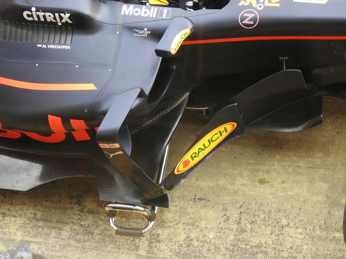

What's the reason that RB would have the rear pull-rod exposed compared to Merc or McLaren, who feed it into the cooling tunnel?

matt_s wrote:What's the reason that RB would have the rear pull-rod exposed compared to Merc or McLaren, who feed it into the cooling tunnel?
Gearbox position. James Key mentioned it in one of his recent interviews. STR12 does have nearly identical pull rod arrangement because TR does use same gearbox as RBR in 2017.

Afair James mentioned that the RBR gearbox internals allow for more freedom in placement.
/edit
Found it: http://www.auto-motor-und-sport.de/form ... 27234.html
Dank des neuen Getriebes konnten wir auch die Hinterradaufhängung so anordnen, wie wir wollten. Da waren wir letztes Jahr von der Geometrie eingeschränkt. Man sieht an der langen Zugstrebe den Unterschied zu früher.
Translation:
Thanks to the new gearbox, we were able to rearrange the rear suspension as well. Because last year we were constrained by geometry. The long pull rod shows the difference to former version.
To sum it up:
Thanks to the RBR gearbox internals they where able to redesign the rear suspension for better geometry and the long pull rod is a result of this.
