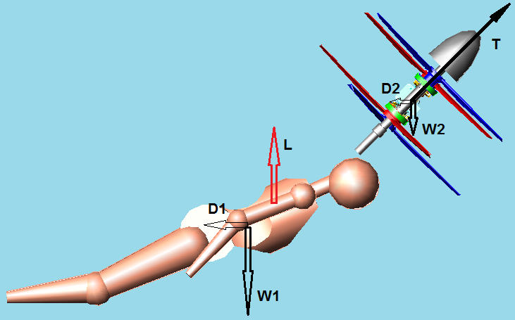

Hello Tommy Cookers.
You write:
“you have now shown motion descending at about 20deg below the horizon - (but bizarrely call it level flight)
level flight is flight motion parallel to the horizontal (in principle for any angle of bank eg 0 deg 90 deg or 180 deg)
keeping with this definition is essential for credibility and compliance with the associated bodies of law”
The drawing is not mine.
It is from the website https://base-book.com/speed-to-fly
The term “LEVEL” is explained at the bottom left of the image as: “LEVEL = NO BANK”
Does anybody know what this means?
For sure it doesn’t mean “Horizontal” (at least according the drawing wherein the FLIGHT PATH VECTOR is some 20 degrees from the HORIZON).
You also write:
“regardless of the above (because it's not a show-stopper at this point) ...
I can't see .....
how you get a L/D of 1.7 for the PF (it's not a wingsuit ?)
how the PF can fly moving parallel to the horizon with the proprotor axis anywhere near the 11 deg shown on P183
The page is the 182.
And here is what I write there for the wingsuiter (of the youtube video) who passes through the rock hole flying at 230Km/h:
  • Judging from the trees and the horizon, his angle of descent is some 30 degrees (1.7:1 glide ratio).
    His vertical speed is 64m/sec * sin(30degrees) = 32m/sec (i.e. his weight is descending at a 32m/sec speed).
  • With a total weight of 165lb (75Kp, 750Nt), the power consumed is: 32m/sec * 750Nt = 24kW = 33bhp.
  • Thus,
    if the wingsuiter had a prime mover (say, some jet turbines like those of Rossy or Browning or Mayman or Zapata) providing 33bhp of push (or pull) power, then the wingsuiter could sustain a horizontal cruise speed of 230Km/h.
  • With a propeller efficiency of, say, 75%, the required power output from the engines of the Portable Flyer is 44bhp for 230Km/h horizontal cruise.
  • For 300Km/h speed, the required engine power is 44bhp * (300/230)^3 = 100bhp (50bhp per engine).”
The above is nothing more than an “energy conservation” equation:
From the video it is estimated the L/D ratio.
From the L/D ratio and the “estimated” weight it is calculated the energy consumed per time unit (i.e. the power consumed) during this “non horizontal” descending flight.
In order to turn the flight from descending to horizontal (D/L=0), what is required is to add energy at a rhythm equal to the rhythm energy is consumed.
The 33bhp is the “net power” required from some Jet Turbines in order to turn the wingsuiter flight from descending to horizontal. When Yves Rossy turns off his jet turbines, he starts descending; if he turns on his turbines, his flight returns to less descending or horizontal or ascending.
In order to provide the same “net power” with the propellers of the Portable Flyer, and assuming a propeller efficiency of 75%, the two OPRE Tilting engines must provide totally 44bhp of power output.
The last calculation is for the power required from the OPRE Tilting engines in order the wingsuiter to fly horizontally at 300Km/h (the power required increases with speed cube).
Is everything clear now?
Thanks
Manolis Pattakos
Tommy Cookers
Tommy Cookers
648
Joined: 17 Feb 2012, 16:55
manolis wrote:
06 Jan 2020, 12:23
You also write:
I can't see .....
  • With a total weight of 165lb (75Kp, 750Nt), the power consumed is: 32m/sec * 750Nt = 24kW = 33bhp.[
    Thanks
    Manolis Pattakos
yes it's clear (I had already edited my post) that ....
if the PF pilot is wingsuited to get L/D of 1.7 the numbers support the attitude shown on P182
but only if the high speed c. 230 km/h is maintained
the wingsuit having such a low aspect ratio its L/D is even worse at higher AoA than at the 11 deg shown
11 deg is not a really high AoA for this AR - slower speeds/higher AoA require correspondingly higher thrust (or more)
the lack of formal proprotor pitch control isn't good but designing for hover below 100% rpm may help the airspeed range
