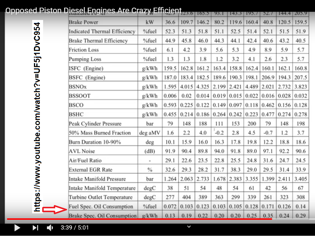

manolis wrote:
17 Jan 2020, 08:13
Hello all
This array (from the Youtube video of Big_Tea post):
https://www.pattakon.com/tempman/Achates_BSFC.png
"talks" for 1 to 1,000 (or so) oil to fuel ratio for the Achates Power 2-stroke engine(s).
(~0.2gr/kWh Brake Spec. Oil Consumption divided by ~200gr/kWh Brake Spec. Fuel Consumption)
Do I (or they) miss something?
Is there a 4-stroke that achieves such figures?
Thanks
Manolis Pattakos
Quite high NOx?
manolis

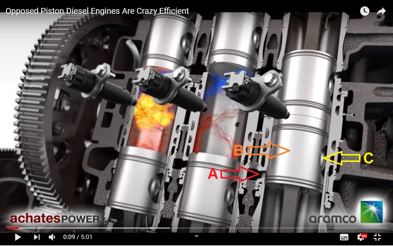

manolis wrote:
19 Jan 2020, 10:01
Hello all.
Here is a slide from the Achates_Power Opposed Piston youtube video (posted a few posts ago by Big Tea):
https://www.pattakon.com/tempman/Achates_OP_Thrust.jpg
A is the exhaust port.
B is the piston skirt.
C is the piston pin.
The piston skirt B abutting / sliding on the cylinder liner (not shown) transmits a thrust force F from the piston to the casing (the inclination of the connecting rod causes this thrust load F); F times the eccentricity of the piston pin from the crankshaft rotation axis makes the instant torque provided by the engine (more correctly: by the specific cylinder of the engine).
To take the heavy thrust loads without wear, it is necessary a thick oil film between the piston skirt and the cylinder liner, no matter where the oil rings (if any) are located.
The piston rings need a substantially thinner oil film on the cylinder liner to avoid scuffing.
So, you need adequate oil above the exhaust port A.
And this oil is scraped by the piston rings and passes over the “hot” open holes pof the exhaust port.
This simply says that you can’t avoid oil from escaping (total loss).
The same with the opposite piston that slides over the open intake (transfer) ports.
Unless they use some “smart” / magic oil that avoids falling into the open holes (i.e. the ports) of the cylinder, the specific oil consumption for this 2-stroke engine of Achates Power can’t be real / true.
The Junker Opposed Piston engines, the “famous” Ecomotors OPOC, the Detroit Diesels of GM had exactly the same problem.
Thanks
Manolis Pattakos
That problem can be reduced greatly by tapering away (increasing the bore diameter) in a spiral (imagine a spiral groove) as you get near the exhaust ports. OR even better just creating pockets to "trap" oil until the pistons return on the compression stroke. Note that the piston has a high crown, and the piston skirt itself has a ring pack, I assume these give stability to the piston as it comes down, ensuring contact at all times, even if you add the "oil traps" near the ports. I have a feeling they are doing something like this.

manolis
manolis
107
Joined: 18 Mar 2014, 10:00
Hello PlatinumZealot
You write:
“That problem can be reduced greatly by tapering away (increasing the bore diameter) in a spiral (imagine a spiral groove) as you get near the exhaust ports. OR even better just creating pockets to "trap" oil until the pistons return on the compression stroke. Note that the piston has a high crown, and the piston skirt itself has a ring pack, I assume these give stability to the piston as it comes down, ensuring contact at all times, even if you add the "oil traps" near the ports. I have a feeling they are doing something like this.”
We talk for a wide band of revs and of loads engine.
It doesn’t fit to use taper cylinder liners, pass heavy inertia and combustion loads through the “contact” between the liner and the piston skirt, and expect longevity / reliability.
It doesn’t also fit to have pockets of lubricant and expect the “based on the inertia of the oil droplets” lubrication to work efficiently from below 1,000 to above 5,000rpm.
The original engine design Achates Power started with, was a “crosshead” design wherein each piston was connected to a pair of “symmetrically” (about the cylinder axis) arranged counter-rotating crankshafts through at least two “straight of bent” connecting rods (this was the basic design of Lemke).
The above would be a great design if the materials where absolutely inflexible and the construction accuracy perfect.
The EcoMotors OPOC had similar issues never addressed.
Initially the OPOC engine presented as the perfect engine for cars motorcycles etc, then it was limited for use in trucks, then it was limited for use in electric generator sets (and other constant revs applications) and finally, after raising some US100M $, they shut the business down.
Unless I am wrong, this video (end 2018):
is, so far, the only case wherein a “Junkers-Jumo”-like Opposed Piston engine of Achates Power was “demonstrated” on the road. Unless I miss something.
Thanks
Manolis Pattakos

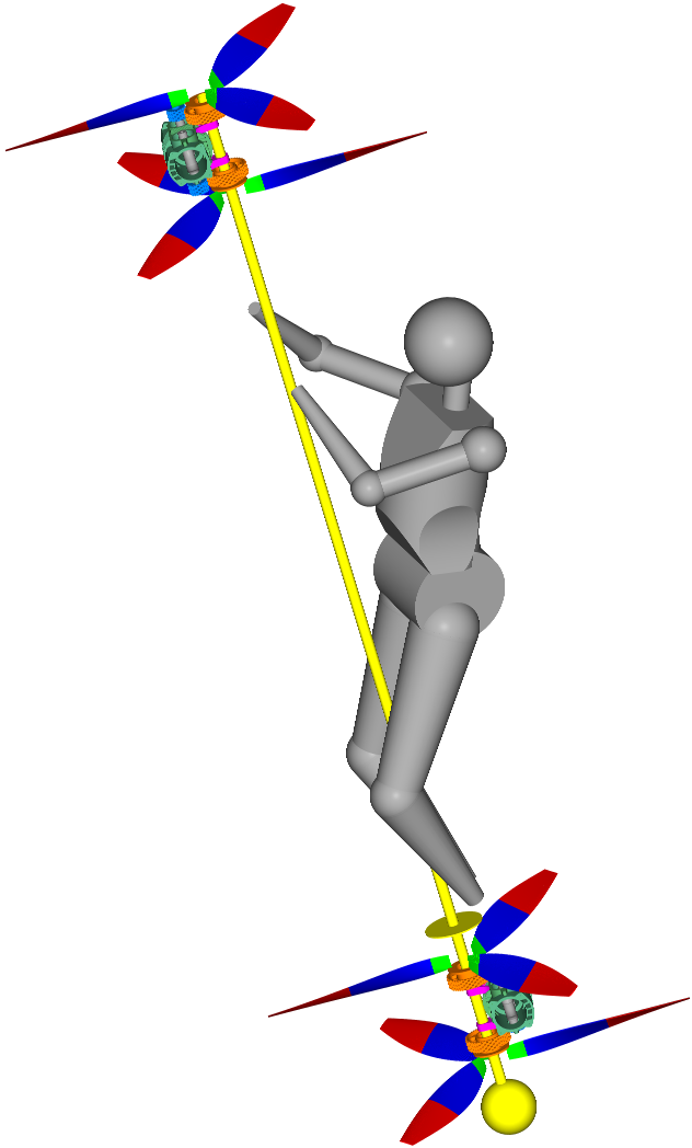

So let me help with a drawing:
It is the “Broom Flyer” of a previous post modified by adding another OPRE Tilting propulsion unit at the bottom of the (yellow) pipe.
Suppose for a moment that the pilot is aerodynamically “transparent”.
Case 1: upper engine running, lower engine stopped.
Case 2: lower engine running, upper engine stopped.
In either case the pilot feels the same, and controls his flight the same way.
The force from the spinning propellers is along the yellow pipe in both cases.
In the one case the power unit is above the pilot, in the other case the power unit is below the pilot.
But the pilot is not aerodynamically “transparent”, which brings a significant difference of the two cases.
With the running engine above the pilot (i.e. with the pilot inside the downstream of the propellers), he has not only “weight displacement control”, but he has also aerodynamic control over his flight: his head and limbs act as flaps / ailerons / fins: deflecting a part of the downwash, they receiving reaction forces which give full control over the flight (yaw, pitch and roll).
With the running engine under the pilot (say, as in Zapata’s Jetpack) the pilot at take-off, at landing, at hovering and at low / medium speeds is based exclusively on “weight displacement” to control his flight. And this is not a full control.

gruntguru wrote:
25 Jan 2020, 08:46
This is nonsense. In a hover situation with an axial thruster, the stability is the same no matter how low or high the CG might be relative to the thruster. An axial thruster always exerts its force along the same axis as that axis tilts. Although somewhat non-intuitive the situation is not the same as a parachute where the thrust remains upwards as the system tilts. (A parachute needs to be above the CG)
True. the main problem with this "hover bike" is that the thrusters are bundled togheter, no so much that the CG is above the center of lift or thrust in this case. Anyway. It's certainly true that it will be quite delicate to handle and a fully fledged FBW could certainly help to keep the thing stable.
