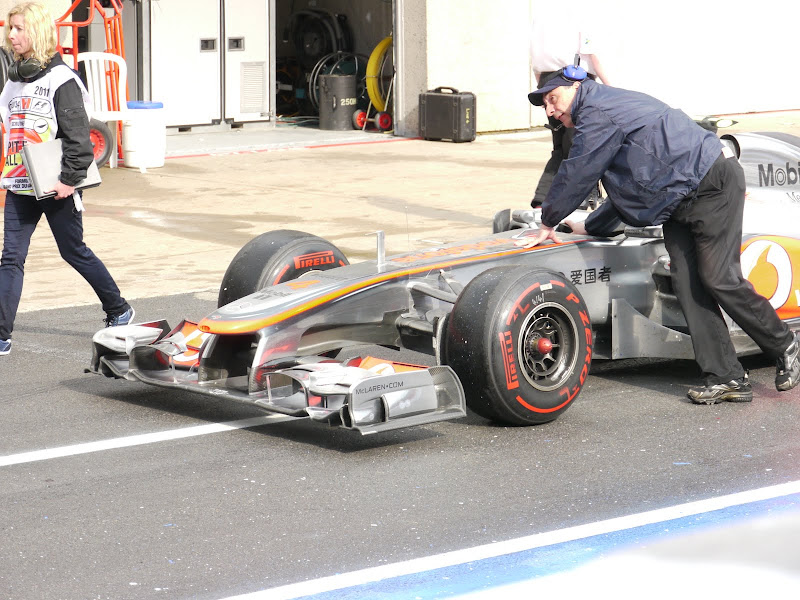

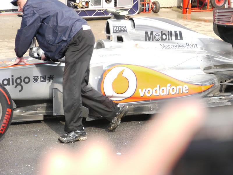

Got some cool shots of buttons car on its way to the fia legality check
You can see all my post race pics from canada here

Quick question from the photos, are the vodafone logos actually red like the last shot? or are they orange like the first few?

ajdavison2 wrote:Quick question from the photos, are the vodafone logos actually red like the last shot? or are they orange like the first few?
I've not seen it in person, but the impression I've always had is that they're fluorescent red. The orange is caused by a lot of light being reflected off it, because it's fluorescent.

I always thought that aswell, and on the various mclaren models I have, it's always red.
Reds in f1 are never reds in real life, they are always orange-ish so that tv viewres see them red

In the next to bottom photo, is that a decal (vinyl) that is peeling away just after the side pod opening? The bottom of the "O" symbol.l
Brian
