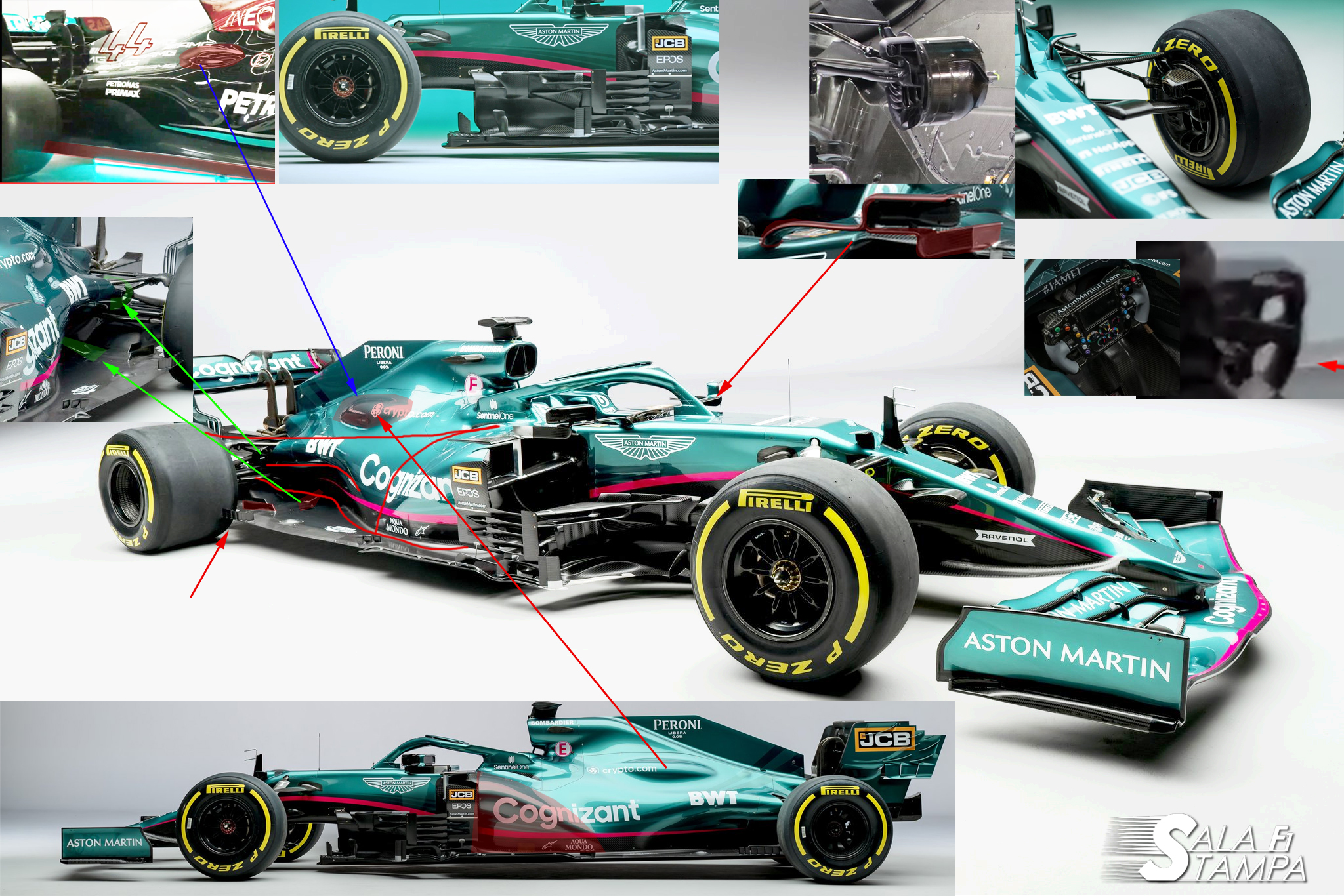

The sidepods downward shape of last years car look way more aggressive. Less steep more roundish. Reminds me of RB

Gone back to the high sidepod inlet, first adopted in 2019 (left).
https://i.imgur.com/BjjqmVv.jpg
I'm glad that someone has something smart to say.
So, they copied themselves. Mercedes is the last car that introduced high inlets, in 2020. And RP went backwards in that part of the car for 2020. Till 2019 they followed Red Bull design, and high rake. Last year, they went to 1 year trip studying Mercedes philosophy. Now they know how both concept works. This year, they have many things from that Mercedes concept, logically as they using most of the allowed Mercedes parts. But with some things they are more like Red Bull, as rounded sidepods.
Agree. To memory — they’re probably the only team that has run on track with both high/low rake solutions?

Perhaps someone could stitch a left vs right comparison photo between this and the W12?

It actually looks a bit lower "frontal area" compared to the Merc, and the angle doesn't flatter that assessment.
It's going to be interesting what this does as having a weird transitional hybrid between high/low rake might give some of the best of both worlds... Especially if it can handle a high variance from track to track.

Zynerji wrote:
04 Mar 2021, 02:40
Yes I do believe the Merc is taken at a higher camera position relative to the car. Which should make the AMR sidepod look smaller(?)

raymondu999 wrote:
04 Mar 2021, 02:49
Zynerji wrote:
04 Mar 2021, 02:40
My point exactly. It's the skinny shot of the Merc and the fat shot of the AMR, and the AMR still has less frontal area.

They are the only team to have ran both low and high rake as well as low and high sidepod inlet with the same spec of tyre in the last two years, so they'll have a large amount of relevant data to adjust everything together, quite lucky how things turned out for them. Tyre's are new this year but that's still a massive help for the new aero behaviors.
Fine adjustment on the nose and front suspension attachment to make it flow a bit better, looks like everything as been pulled in a bit more everywhere, but I'd never noticed the bump on the right side after the nose horns, it was there already last year but I guess its standing out more in green than it did in pink. I wonder what's there that needed just a bit more space.

raymondu999 wrote:
04 Mar 2021, 02:49
Zynerji wrote:
04 Mar 2021, 02:40
Not just that but from slightly different distances. There are fixed dimensions on the cars and those vary between the "halves" of that split image. So care is required comparing the relative thinness of the two cars.

Interestingly we can see they added fins in the floor, 3 in the "front", and 6 of them in the "back".

For me that bulge on the Aston Martin sits more backwards than on the mercedes. But the engine itself should be more or less in the same position. Maybe I misjudge it.

Raleigh wrote:
03 Mar 2021, 23:35
https://i.imgur.com/qvkZq4Q.jpg
Aggressive floor treatment with a cutout and finlets for vortex generation and sealing the floor. Haven't seen this on any of the cars revealed yet, will be interesting to compare with the W12 when Mercedes unhides their floor.
The Alfa Tauri has this. It's a new ideaoverall though. Cant say I have seen it in any previous years.
Engineers trying to create a strong floor sealing vortex again. It won't be as efficient without the floor gills thats for sure though.

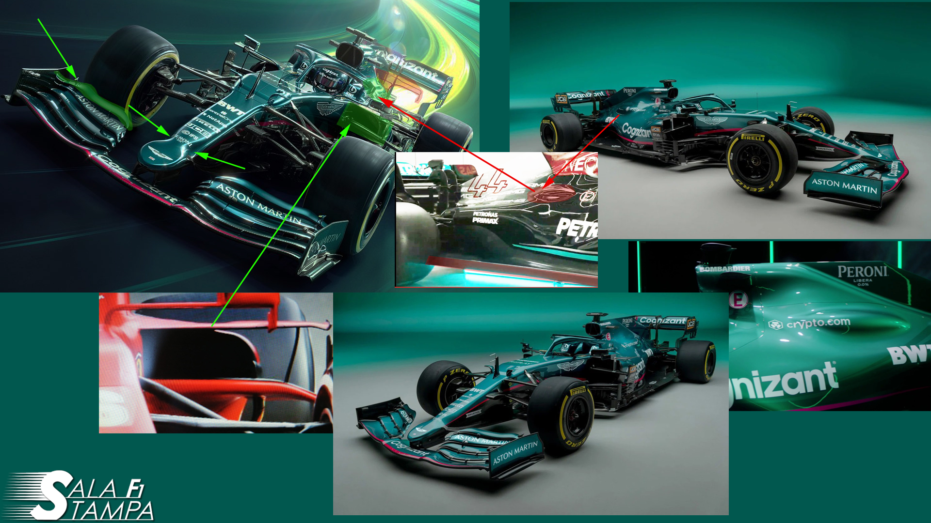

Zynerji wrote:
04 Mar 2021, 02:40
I don't get the transitional hybrid part?
Isnt it the same Mercedes suspension and gearbox. Not to mention whatever they copied from the chassis amd wheelbase?

PlatinumZealot wrote:
04 Mar 2021, 15:11
Zynerji wrote:
04 Mar 2021, 02:40
Exactly, there is no "hybrid", the AMR21 is full on low rake Mercedes style. Any difference between comparison shots are down to different angles and focal length.

Raleigh wrote:
04 Mar 2021, 16:16
04 Mar 2021, 15:11
Zynerji wrote:
04 Mar 2021, 02:40
Isn't it the same Mercedes suspension and gearbox. Not to mention whatever they copied from the chassis and wheelbase?
Why would any of that have anything to do with the ride-height settings and the aero effects they cause?
It has been shown that the AMR01 is NOT a direct copy of the W11/12, so that means that it is developed in-house with their personnel and knowledge. It is not inconceivable that the AMR could run at 110% Mercedes ride height, even with the Merc suspension, as the aero surfaces could be tuned to do just that.
We don't know, and that's why I speculated on the possible hybridization of the 2 designs.
