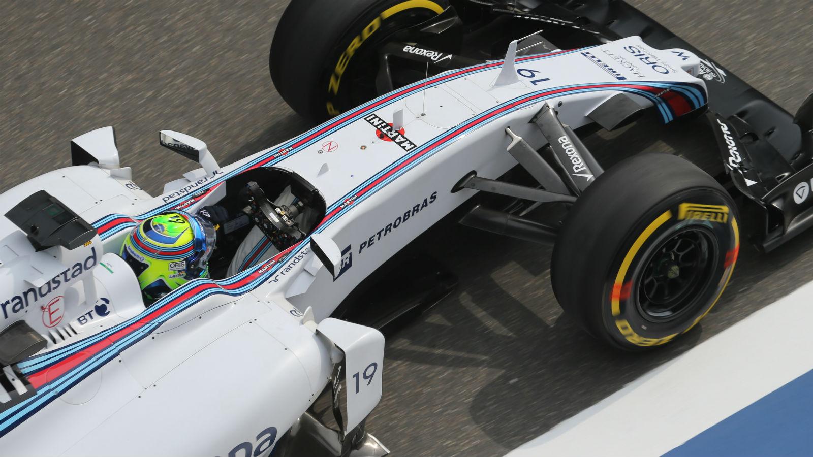

Today pictures!

Well the Williams FW36 was challenging Mercedes for wins, now the FW37, which was designed in similar fashion to the 36, is quite far behind. The PUs are the same between the two. Williams has a new fuel supplier, so maybe they are down on power?
Ferrari may also be actually pushing Mercedes harder than they were pushed last year, so the gap may look bigger because of it.
Symonds noted they worked hard on the nose for the 37 because they lost a lot with the new regulations. Maybe the nose regulations last year allowed enough air in the front to help with the diffuser. Now, they may need to try to slim the undercuts on the sidepods to get more air rearwards?
I think there are a lot of small detailed complex things going on at the front of some of the cars that Williams hasn't gotten to grips with since they are focusing on efficient, slippery cars. Their sidepods could also be designed to flow air inside of them efficiently, too. They are all exhausting air in similar areas, the Williams is just shaped a little different.
