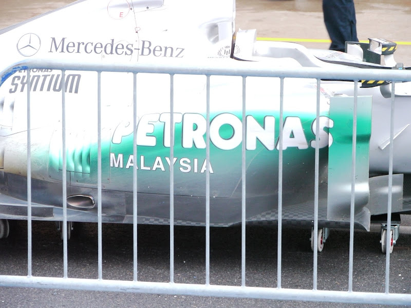

hecti
hecti
Joined: 30 Mar 2009, 08:34
Location: Montreal, QC
Re: Mercedes GP W02
Thought I'd share some pics i took this weekend after the race:
you can see all my post race pics here
