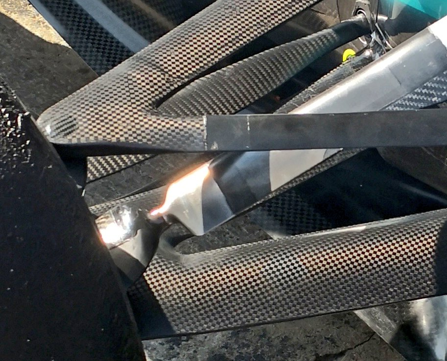

Re: Mercedes-AMG F1 W10 EQ Power+
PhillipM wrote:
21 Feb 2019, 20:18
PlatinumZealot wrote:
21 Feb 2019, 19:59
OK I these new angles give me a new opinion on this thing.
It really looks to be a ball joint. Crazy I thought at first. But not really if we think about it.
Look at the line of action going through the push-rod. Look where it intersects at the hub. The other saving grace, is that the F1 car suspension travel is very small, so angular changes are minuscule compared to road cars.
NOW... What about the STEERING and bump steer and loading into control arms?!! I am hearing...
This is MY theory on how they get the bump steer right and the loading and the stability and all those kinematic issues sorted: Inside that Bulb, I feel there is a small linkage or cam mechanism that slides the base of the push-rod along an axis to keep the push-rod from getting jacked up or pulled down when the wheels are turned, and during braking events when you have a bit of a toe change. What do you guys think of this Idea?
I think you're way out. This is nothing new, and it's not something that's seen just in F1, it's just with Mercs inboard upper pivot it's more in the limelight. Offset pushrods cause steering loads on bump, but they don't cause bump steer in and of themselves.
Even boring McPherson strut road cars have achieved similar effects to this with rotating arb mounts/tabs for decades.
You can't compare to McPherson strut of all things!
Never said push-rods is main cause bump steer, but any other "offset" linkage mounted to the wheel hub will influence the steering of it around its axis. It's just regular schmegular kinematics.
I implore you to look very carefully at Mercs's layout. I don't want to draw it in a cad program to see that they have to compensate for such a huge radius away from the king pin axis.
Your pivot is still through the wishbone attachments, so no. Of course you can compare it to a Mac strut - the attachment is doing the exact same thing, changing spring/bar preloads with steering. No different at all.
PhillipM wrote:
22 Feb 2019, 17:48
This is what I mentioned here! And i put it in Italics because it is important.
We would have to confirm whether the mount is to the hub or to the wishbone. If it is the wishone... it doesn't matter you can have whatever shape or length of mount you want and the discussion is moot as it only affect the push-rod loading and no part of the steering kinematics.
So let me know if you have any information on if it is mounted to the hub or to the end of the lower control arm.
On an aside, I have to point out that there is a carbon fibre covering there.. we know the hub is metal. So it must be covering something.
386
Joined: 16 May 2011, 15:18
It's mounted to the hub, but it still doesn't change your steering geometery, only your loadings, it would have to snap your tie-rod to alter your steering geo, the rules don't allow for multi-link type setups #-o
I don't get why this is such a big deal, pushrods have been mounted off-centre on hubs for decades on all sorts of different race and road cars, it's hardly revolutionary.
The interesting bit is why Merc have suddenly decided to push it as far as they can in the regs when they didn't use it that extreme previously.
