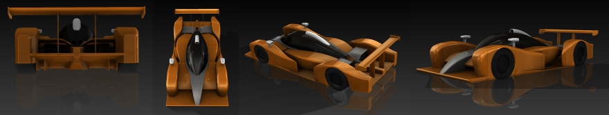

First picture of the new car MP006A:

Hi, I apologize if I'm in a hurry, but I can work on MVRC projects until next week.
This should be the customer car. It has been designed in compliance with the full class 2018 rules, but it is also compliant for the intro class. It is simplified edtion of the official car.
My intention is to provide STL and STEP models to everyone, but, considering that I have only few days to complete it, I would ask a little help, once the STL model will be available on this forum.
It would be useful if Chris could take a look to the car and check if it is legal, and André could run a simulation (model and results should be visible to everyone).
A parametric (SWX) or semiparametric edition would be possibile not before 2nd or 3rd race.

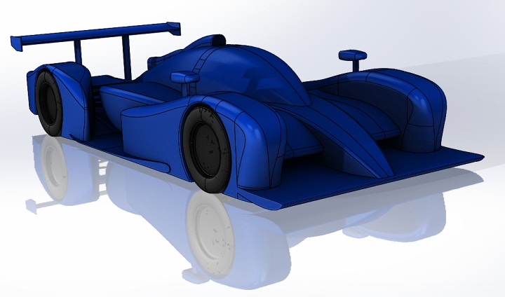

Hi, these are the STL files of the "intro class" car.
I am sorry but the time between the rulebook release and the first race is not enough to provide a parametric car (or interchangeable parts for who does not use use Solidwroks).
This car includes most of the concepts of my 2017 car, that was quite a good car, so you can study it and understand any small trick.
In my opinion the intro car rules (and engine) should be the same of top class, so that these cars could compete for the podium. The only additional limit should be to "frozen" everything included beteen the front and rear axles and to not allow rake changes (in order to run a small number of CFD simulations).
Here is the link... have fun!
http://www.caedevice.net/SERVER/MVRC/20 ... _Rev01.zip
There will be e "Rev02" after LDVH simulations and Chris rule check. The post processing will be available for everyone.

Yesterday Matteo pointed out some issues with the software to me. One is a bit bad. It is related to the new Windows version of OpenFOAM. In the simulations we have an automatic switch to start the run with first order accurate numerical schemes which then get switched to second order. This switch to second order currently does not work under Windows, which means that your end results are not what they should be. You can find the bug report here:
https://github.com/blueCFD/Core/issues/108
As I do not work on this, I cannot help with the bug fix and we can only wait. BlueCFD has however recommended a good work around which I will try to implement today. Depending on how things go, I might have to delay the first race.
I have also simulated the new Intro class car. It seems that the heat exchangers do not see enough cooling flow and the car needs some more rear downforce. I could work on that part. However why is the car complete? Shouldn't the guys get a car without front and rear wind and also without the diffuser?

LVDH wrote:
18 Jul 2018, 08:03
Thanks. I was quite sure about the need of more rear downforce, but I am surprised by the cooling flow.
Could you make the post processing public so that I can prepare a Rev2 of the intro-car?
The caris complete because it is a work in progress. I think that making the development public would be an additional help for beginners. I will make an article on my website, but you can use it on the official website too.
After 1 or 2 development iterations I will release a final version with some separated parts (rear wings and other parts), but I am not sure it will be ready for the first race.
