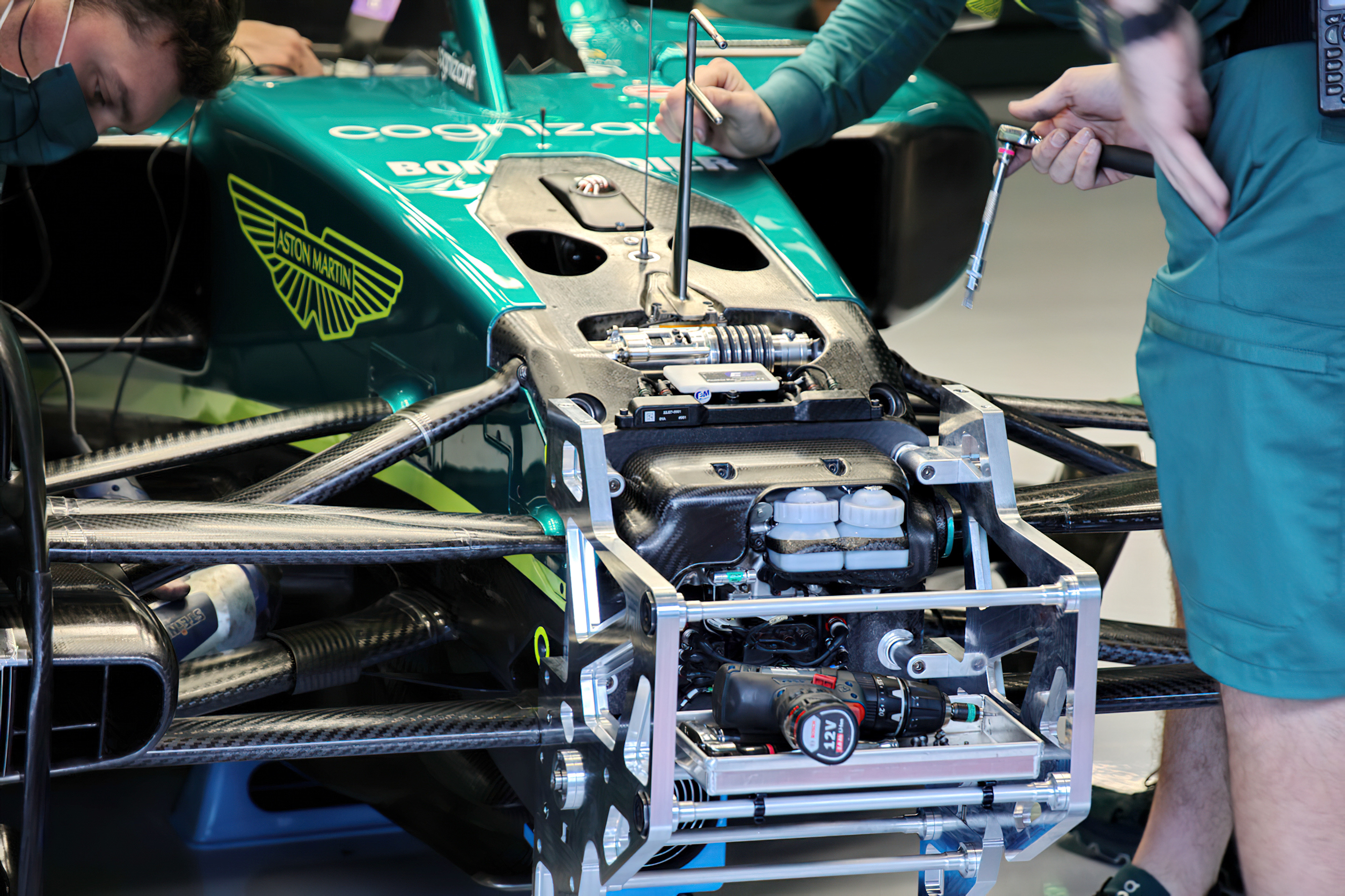

What i notice with this car is not just how high the upper arm is, but also the spacing between it and the lower arms.
The pushrod designs such as on the aston the two arms have a narrow space in between compared to this car.
Also the steering link angle seems to be very steep. If im not confusing the steering link from the rear arm.
Interesting suspension design but i guess we will see how it works on track and why they did what they did with the arms.
