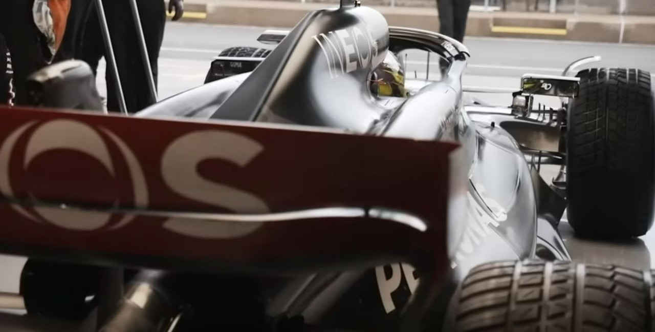

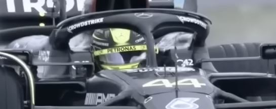

Could those 2 channel bath tubes also generate load/downforce (maybe near the car`s CoG or CoP?) in addition to their main cooling function?
Which could be something that RB18 pioneered since Silverstone 2022 update?
It seems that drivers ran without the windshield both in dry and wet conditions at the shakedown adding to my above theory:
And last but not least: how are the rear wing and the beam wing influenced by the hot air coming from the cannon outlets?
Any sort of downward turning surface is going to generate some lift but usually the payoff is in using the redirected airflow to power up something like the diffuser or the rear wing far more than any lift generated by the surface.

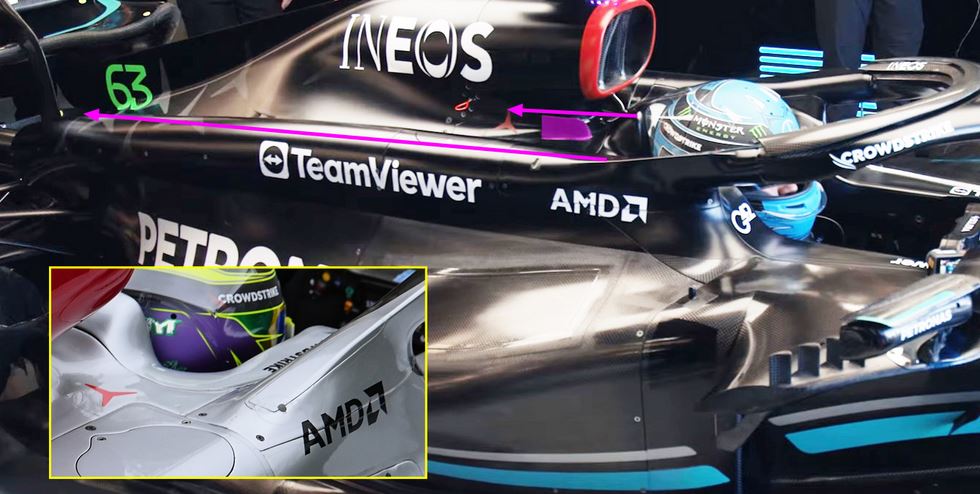

atanatizante wrote:
20 Feb 2023, 15:49
This upper stay is new? What`s the use of it?
http://postimg.cc/BLH1ZDjM
Ties to the diffuser.

atanatizante wrote:
20 Feb 2023, 16:02
In theory…
Any downwash created by the upper surface will increase the effective AoA of the rear wing in that location.
If a significant ‘clean’ flow volume is pushed/drawn through the cannon outlets it will have an effect on the beam wing (increasing the flow/pressure on the upper surface), if the flow is very turbulent it will have less effect.
Moving from louvres to a long tubular exit cleans this flow up, most likely.

atanatizante wrote:
20 Feb 2023, 16:02
http://postimg.cc/PND4BPTq
https://postimages.org/

atanatizante wrote:
20 Feb 2023, 16:02
I think they are disigned so wide apart to line up with the Halo's mouting points to minimize turbulent losses from the Halo. Basically it's just generic streamlining IMO
