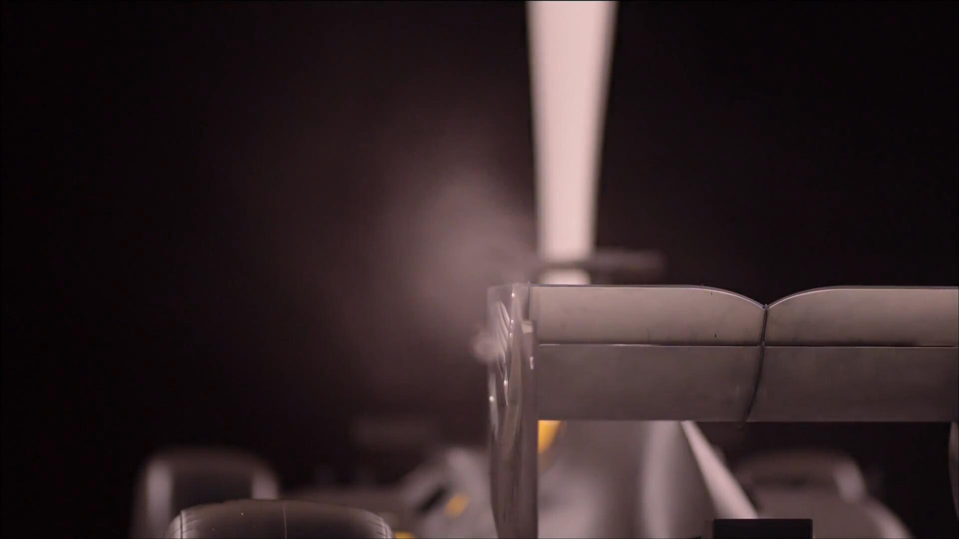

Not CFD, but still interesting... vortex formed behind the Red Bull's RWEP trailing edge as a result of the lift-induced drag. Gif is too large for embedding [9.56MB], so click here or on the picture below to see full animation of the vortex build-up:
