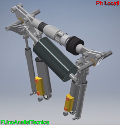

Very interesting! You have to read the whole article!
F1 2017: è illegale la sospensione con attuatore idraulico sull'anteriore di RedBull(F1 2017: it is illegal suspension with hydraulic actuator on the front of RedBull)
http://www.f1analisitecnica.com/2017/01 ... e-con.html
Google translate: "Thanks to photography at the top we can unveil a preview of how it was made the front suspension of the Red Bull RB12. What many thought was a simple damper RHS with so RedBull solution single-damper or with a non-symmetric solution (damper vertical LHS) was actually a hydraulic actuator, component does not directly connected to the true third element but only indirectly through the rocker suspension."

Regarding intelligent valving in the third element. Some years ago one team (Lotus, RBR?) had a system where the front brake hydraulic pressure closed a valve in the front shocks thereby altering the dive of the car. It did not break any written technical rule but it was queried by another team & ruled to contravene the active aerodynamic rule. My recollection is not clear.
However if these third suspension elements have valving that responds to outside forces then they can be ruled inadmissible in the same way.
For this ruling to come in so close to the start of the season is a big impediment to the teams intending to use it. But something very similar happened a few years back. Something RBR had to abandon I think but I don't recall what (the tea tray?).

LookBackTime wrote:Very interesting! You have to read the whole article!
Interesting stuff. Also interesting that although people have linked Mercedes with this story, it seems that the RedBull system is more obviously an aerodynamic control. The Mercedes system seems to be more about suspension for tyre benefits. If that is the case, then Mercedes might be able to run their system in 2017. If so, expect them to be at some advantage, initially, unless Ferrari have developed a similar system themselves.
I read somewhere (in Italian press I think ) that Mercedes are very confident in their system and will continue to use it in 2017. They think that they are respecting all the regulation. So, not back up from them.
