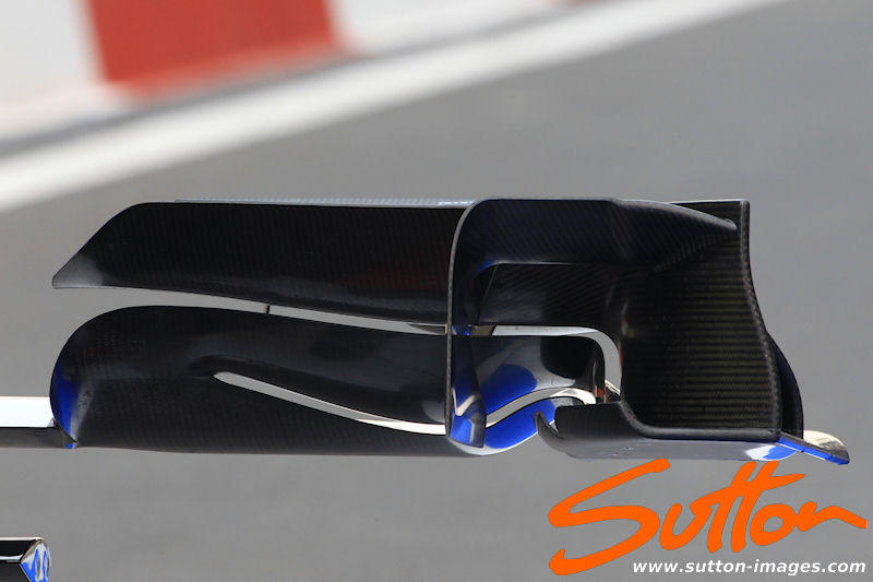

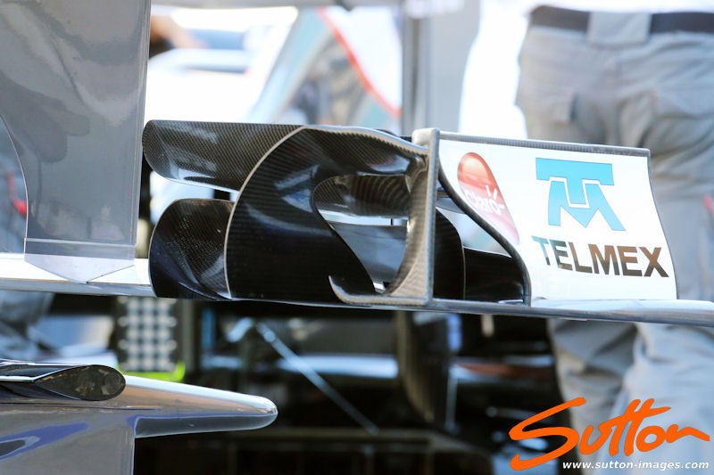

Re: Sauber C31 Ferrari
That front wing is just amazing, its the most intricit and beautiful on the grid.
wrcsti
wrcsti
Joined: 06 Apr 2009, 04:46
Huntresa wrote:That front wing is just amazing, its the most intricit and beautiful on the grid.
yep, its more diffuser than wing
