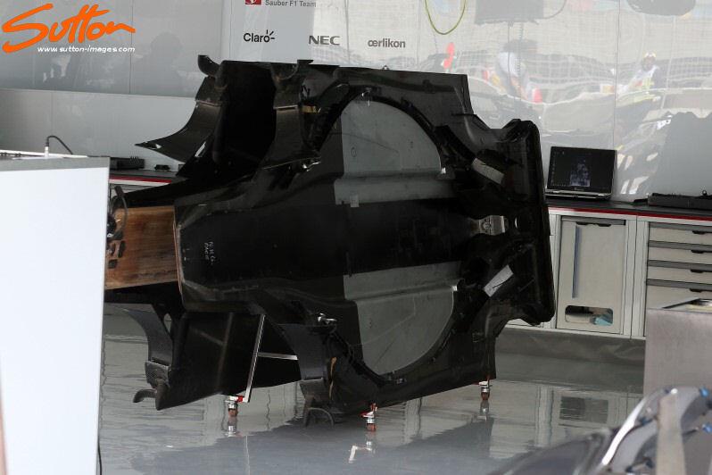

The downwash for the exhaust is kind of enough, though. This is from February testing:
Edit: pointing at the rubber stuck to the floor, which must have been hot.

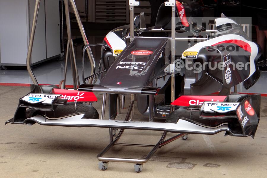

Spain 2013 - Thursday (09.05.2013)
New positioning for the camera housings.
via Tobias Grüner
Holm86
249
Joined: 10 Feb 2010, 03:37
Re: Sauber C32 Ferrari
The camera mounts on the nose is new. More Red Bull'ish ....
patrik
patrik
Joined: 28 Mar 2013, 00:59
Nobody's talking about that FW? It's nothing like I've ever seen! So many new shapes and concepts!
