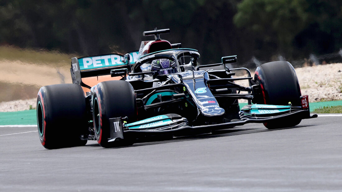

Re: the W12, I thought the above photo did a really good job demonstrating the "Z-shaped" floor, which can be read about in more detail here:
https://www.formula1.com/en/latest/arti ... Jb5U1.html
Thought it was a fascinating development choice, as cutting the Z into the floor's sides actually results in shedding some floor area from the car.
Excerpt:
"The cut-out itself, working in combination with the vane atop of it, could be creating a vortex of spinning air which is then sucked to the underside edges of the floor, thereby helping seal it, so retaining that negative pressure.
These vortices form virtual ‘skirts’ (so named after the physical rubber/ceramic skirts which were banned in the 1980s) keep the airflow of the main part of the floor energised. The faster that flow, the greater the downforce. The job of creating the vortices on the outer edges of floor was previously done by the floor slots which were banned for this year."
I thought the slots just helped with pushing the turbulent tire wake outwards not to create vortices? Correct me if I’m wrong??
That’s what the slots/holes at the rear of the floor were designed to do: to manage the disruption to the airflow caused by the rotating tire. That airflow otherwise tries to wreck the consistency of underfloor flow that feeds the diffuser.
Like you said, those slots allow the excess pressure to vent, rather than being injected into the free airstream.
These slots were typically angled. The excerpt above was referring to the vertical slots running parallel to the floor’s edge closer to the side pod area.
Thanks for the clarification….

holeindalip wrote:
29 Apr 2021, 22:00
zibby43 wrote:
29 Apr 2021, 20:42
holeindalip wrote:
29 Apr 2021, 16:13
Welcome! You were 100% right about the rear slots/holes. Excerpt wasn’t specific enough about which set of slots was being talking about.

=D> =D> =D> That is an amazing picture! Shows how much the rake truly is on a "low rake" car!

According to my fast paint caluculations, it is around 1.2 degrees rake.

zubster wrote:
30 Apr 2021, 14:51
To be fair it probably has been increased from last year. I’m curious to see a comparison shot

When the car is stationary Judging the level of rake can be hard.
When it's moving with down force acting on it, it looks a lot less.
But it does look like the back is up higher than it was before imo.

ScrewCaptain27 wrote:
30 Apr 2021, 15:37
zubster wrote:
30 Apr 2021, 14:51
James Allison said it had been increased during last year's launch video. I don't see an increase over last year. I saw an increase last year over previous years where it was as low as 0.9 degrees.

Check out how the rear wing flow is driving the exhaust gases upwards. Quite impressive!

I don’t think you can compare those pics as we don’t know relative speeds.
On another note, is it me or is the W12 front wing looking relatively simple compared to the most recent iterations at RB, AM, etc.
The RB and AM wings have ondulations on their elements whilst Merc’s elements are flat.

The fact that they are all from different points on the track means that the images say absolutely nada.

wesley123 wrote:
01 May 2021, 15:35
Are there any pics of the w11 at the same turn? That can definititely determine the rake angle differences if any
