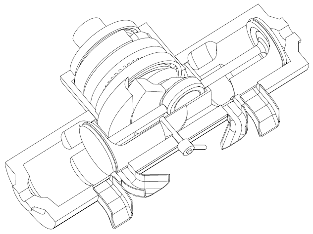

In the PatTwo Harmonic engine below (more details at
http://www.pattakon.com/pattakonPatTwo.htm )
the thrust loads between the piston skirt and the cylinder liner are minimized (they are several times lower than in the Honda 2stroke).
Besides being rid of reed valve(s), the PatTwo Harmonic engine is perfectly balanced (zero inertia forces, zero inertia torques, zero inertia moments).
Compare the basic kinematic mechanism of the Harmonic PatTwo:
with that of the Honda 2-stroke.
The most interesting is the load control it uses and the minimization of the pumping loss at light loads:
the engine idles (and operates at light / partial load) with the throttle valve (the dark part with the yellow lever at the middle) fully opened,
with the throttle valve progressively closing, the engine runs at higher revs and heavier loads,
with the throttle valve completely closed the engine provides at high rpm a lot of power,
and when the revs get adequately high, the wide opening of the throttle valve gives (in cooperation with a tuned exhaust, if any) full power.
