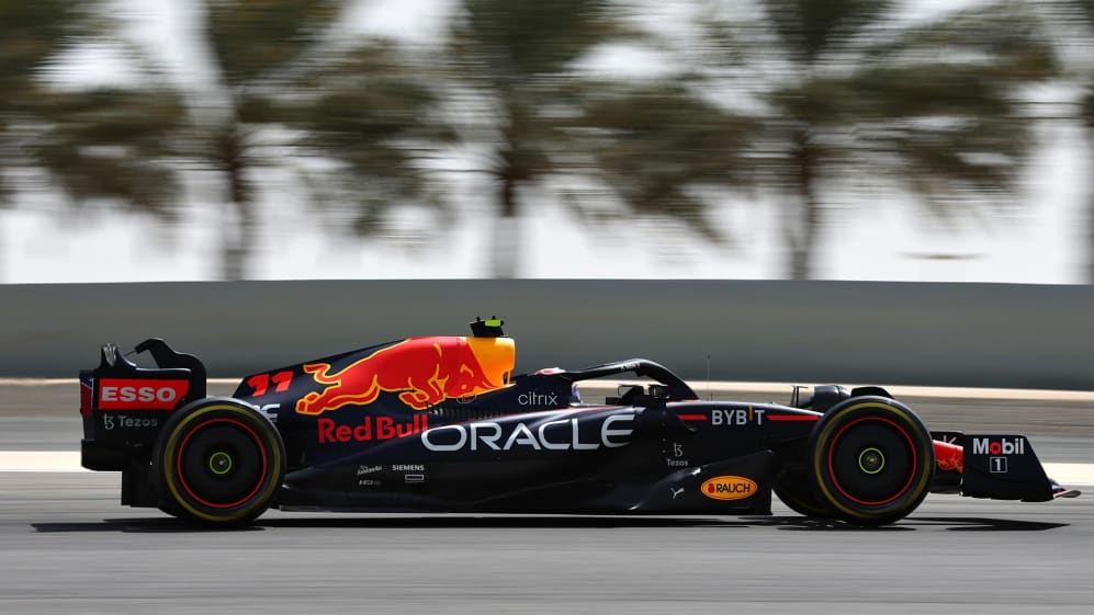

Image of the car from the last day of testing. As most commentators and writers have noted, Red Bull have added a bit of rake to the car.
