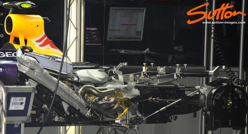

Re: Red Bull RB9 Renault
China 2013 - Thursday (11.04.2013)
via Matt Somerfield
