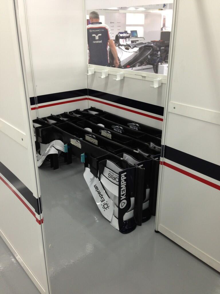

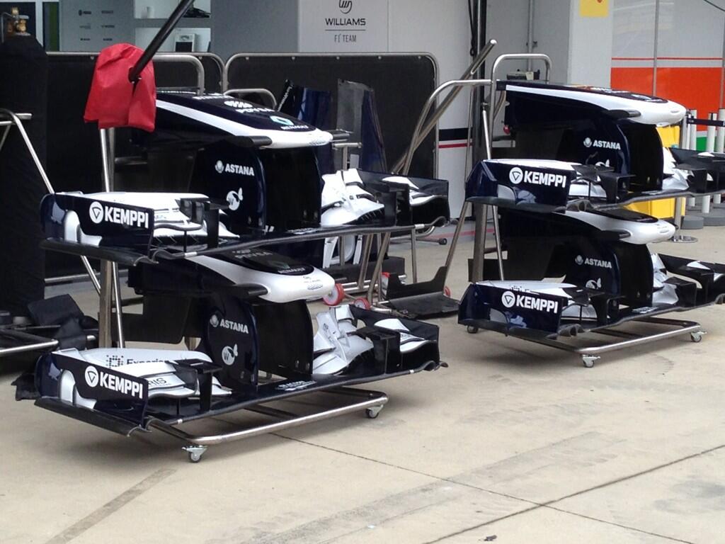

New front wing on the left (similar old on the right)
204
Joined: 23 Feb 2008, 17:55
Re: Williams FW35 Renault
That front wing update is pretty neat. Hopefully for them they'll finally run it this race, that would give a sign of improvement at least.
