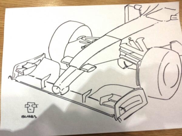

ScarbsF1's latest draw (Thank you!):
He's comments too:
"...and here's what lies under the new @MyCaterhamF1 finger nose; slim crash structure, vanity panel & hooked chassis "
" it creates the slimmest nose tip, funnels more flow under the chassis for more downforce"

scarbs
scarbs
393
Joined: 08 Oct 2003, 09:47
Location: Hertfordshire, UK
Re: 2014 Design
The diagonal line rule only applies to the crash structure, the vanity panel above is exempt. granted the top edge of the crash structure probably could be straighter than drawn, but the concept is all there.
