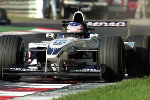

That low nose is very narrow.
And you have to remember that the wing flap extends underneath that nose. That element will turn air upward so there wont be any flow separation under the nose.
With the current rules with as standard symetrical midwing, there is no upwash to speak of to keep flow attached under the nose.
Add to that the fact that the nose must have a minimum crosscetional area no smaller than 500 cm2 ? 70mm from a certain distance from the front wheel center line, which basically means narrow nose tips are not allowed, you will have a broad bent down nose with a lot of bad air flow underneath it.
What we are seeing with this mclaren was simply because of the front wing regulations which permit all manners of wing elements.
If you look on what BMW's Albert computer did with their table top nose, then you will see that that confirmed the standard for the superior design. The BMW had the sidewash endplates too, and they were criticised as beeing egg cartons. Lo and beyold people didn't fully appreciate what ALBERT was getting at with the sidewash wings and high nose.
