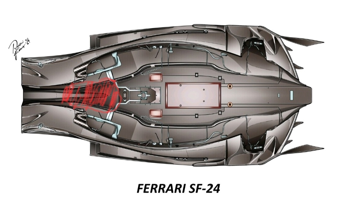

Can someone please point to where the gearbox sits exactly?
It's right in the middle of diffuser ramp :)
Vanja #66 wrote:
09 Mar 2024, 18:08
yellow is pressure recovery around the gearbox case
Speaking of gearbox, there's an article about it (and rear suspension) and an illustration from Piola. Disclaimer - Not sure if he has a photo and did his usual detailed overlay or if this is an illustration based on other SF24 photos and SF23 gearbox.
https://www.motorsport.com/f1/news/why- ... /10589033/
#Aerogimli

deadhead wrote:
20 Mar 2024, 21:34
Andi76 wrote:
20 Mar 2024, 21:23
https://postimages.org/
Not quite true to scale and the final drive goes two millimeter further back and then you have the rear crash structure:

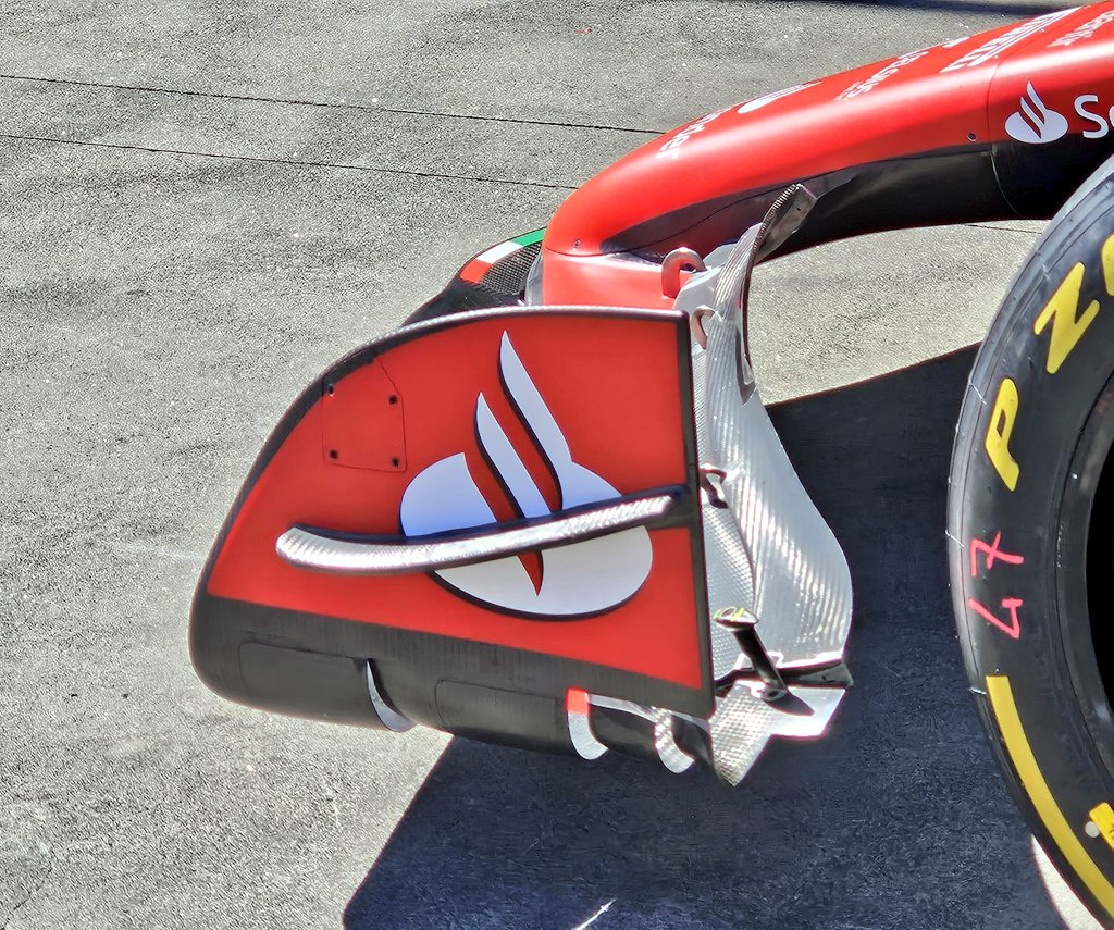

Nice to see them going with the ‘hiding in plain sight’ outwash encouraging small/short FW endplate idea from the RB19.
There is some very nice detailing on the car this year.

Best view of the floor inlet so far. Very subtle changes compared to SF23 Japan floor, there could be a bigger change coming in Imola.
SF23 (Qatar?)

Very interesting images there.
It appears, to me, that the outer three routes of underfloor are relatively crude in just getting as much volume out the side of chassis to remove from flow underneath into venturi, consequently they're maybe less sensitive to shape, form etc.
The first "strake" next to the monocoque "hull" front end, would appear to hold much more intricacies in its overall effect, it's relative balanced volume against rear diffuser performance, also the parity of flow distribution to each side when presented to yaw approaches, then to differential negative pressure from one side in contrast to the other.
There's quite a bit of thinking and shift in these two strake noted above from each of the teams, clear importance of performance and understanding seems fundamental to overall effect, more so than some of the other elements.
Stu
Joined: 02 Nov 2019, 10:05
Location: Norfolk, UK
Re: Ferrari SF-24
I think that the most successful floors are using the outer strake to manage tyre wake (and keep it out of the underfloor); the outer pair of underfloor channels to create a longitudinal Venturi throat (thereby promoting a forward biased CoP at lower speeds - before the rear suspension has dropped under load). This allows for a rearward biased ‘main’ Venturi throat into the diffuser which moves the CoP rearwards as speed increases.
The front floor edge is being turned into a wing profile. The inside strake can be trimmed to suit the required aero map on a track specific basis.
