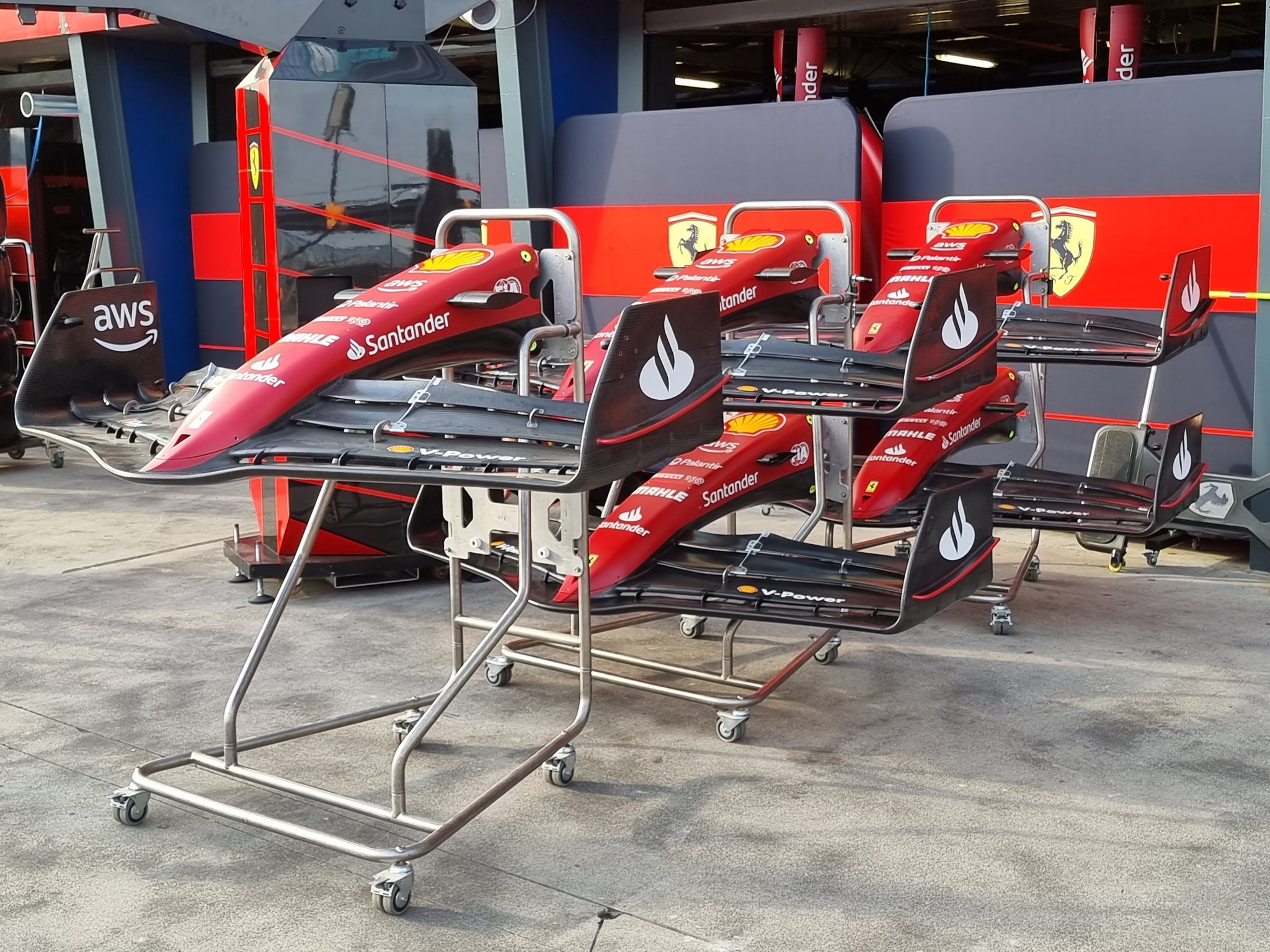

I don't know if there are new noses, but at least they have different stickers. :lol:
