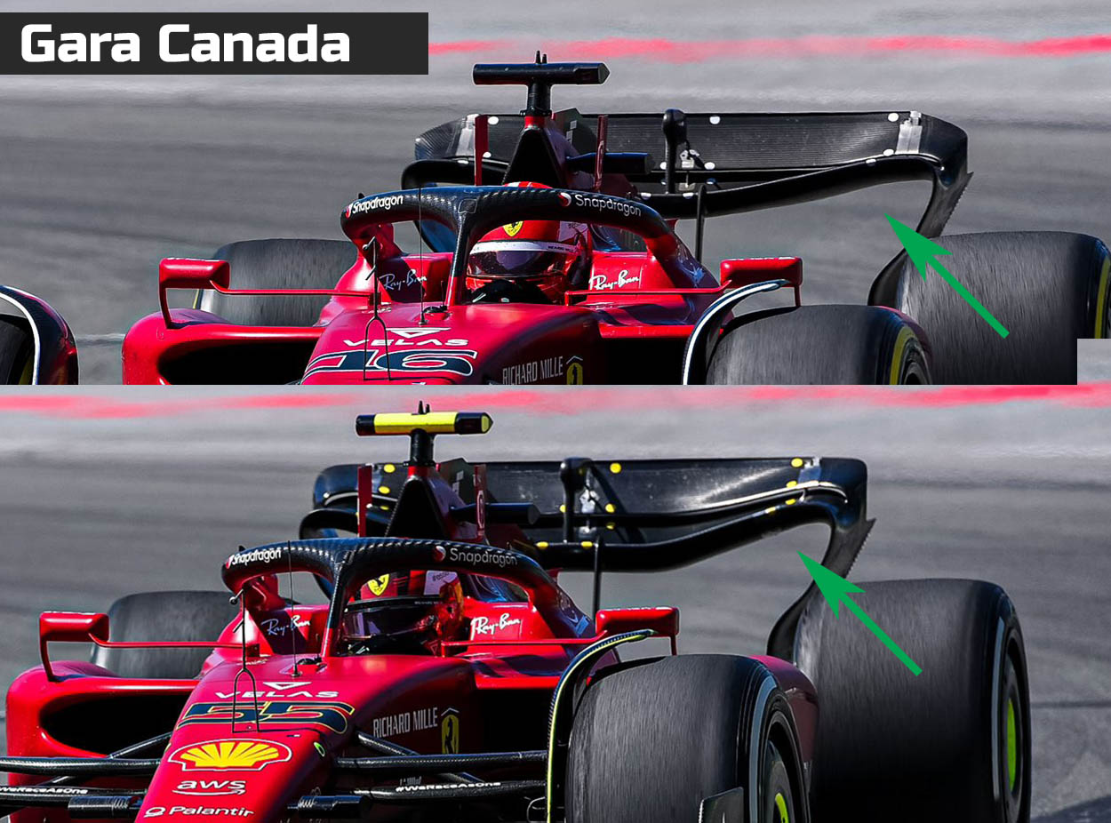

Charles has a different (all new) rear wing compared to Carlos, suppousedly lower drag.
Beam wing also slightly different.

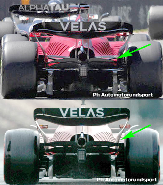

Finally a comparo of the old vs new beam wing

Ferrari all of a sudden has a bunch of wings...
Barcelona/Monaco- Max downforce.
Montreal (Carlos)- Medium high.
Montreal (Charles)- Medium low.
Baku- Low drag.
Too bad we didn't get a good comparison between the 2 versions in terms of pace, Charles topped the speed trap while Carlos was 15th some 11 KPH slower (tow and other things might've influenced this gap).

Old
New

Its endless compromise. I think Ferrari as a team is quite experienced in such compromises and setups. Especially last years experience with "low drag" packages.
This year is quite obvious that RW plays huge role how underfloor interact with it. And yeah i almost forgot beam wing is crucial in that aspect also (even more). So teams can modify actual floor extraction on whole diffusor perimeter by RW AoA and flex quite dramatically.
Beam wing is very sensitive device. That would explain why Ferrari dint change it so often this year till now. Its geometry becomes quite intricate. Its obvious they wanna make car more racier in race conditions even when in off position. Beam wing is seemingly more shallow in maybe even have even more cross-span flow. But that is huge speculation. Best deal would be efficient floor with smallest RW as possible.
